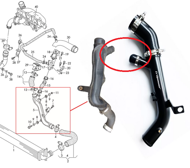

The Forge kit (I can no longer find to be available) should come with everything except for the throttle-body inlet pipe necessary for the DV relocation.
Whether it's OEM or aftermarket, it needs to have this port (circled) to connect the DV adapter to using a short hose...and then a longer hose goes from the DV to the inlet port on the REVO intake.

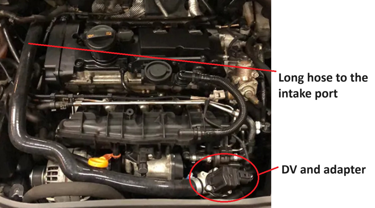

This shows locations and it also requires the extended DV's wiring loom/harness;
