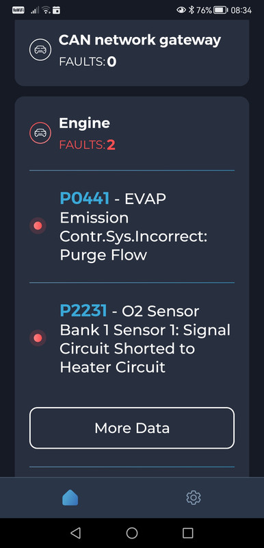

The engine management light has just come on. Did a carista scan and bought up these codes.
I've been told that it would be easier to change the sensor if on a ramp and also to get a Bosch one?
Looked on auto doc and there's 4 on there so bit confused... I'll try and put a link up for that.

The 441 code could be just a fuel cap seal.

I'm more concerned about the 2231 code and if I can still drive the car until I can get it sorted?

You can drive it but it won't go into what was call closed loop so the fuelling will be off
