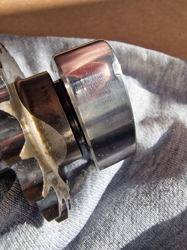

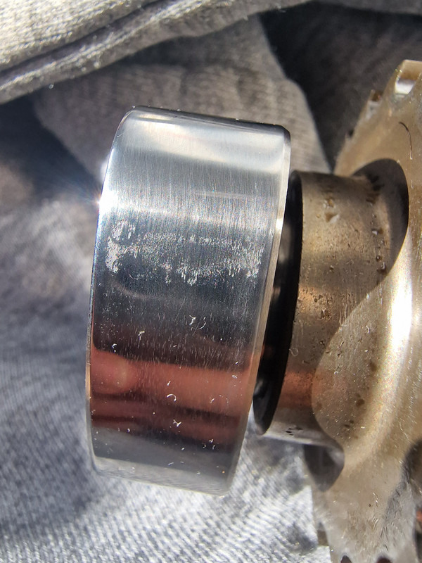

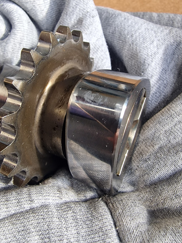

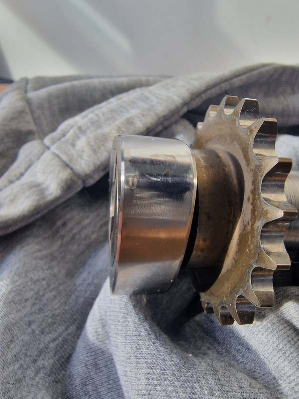

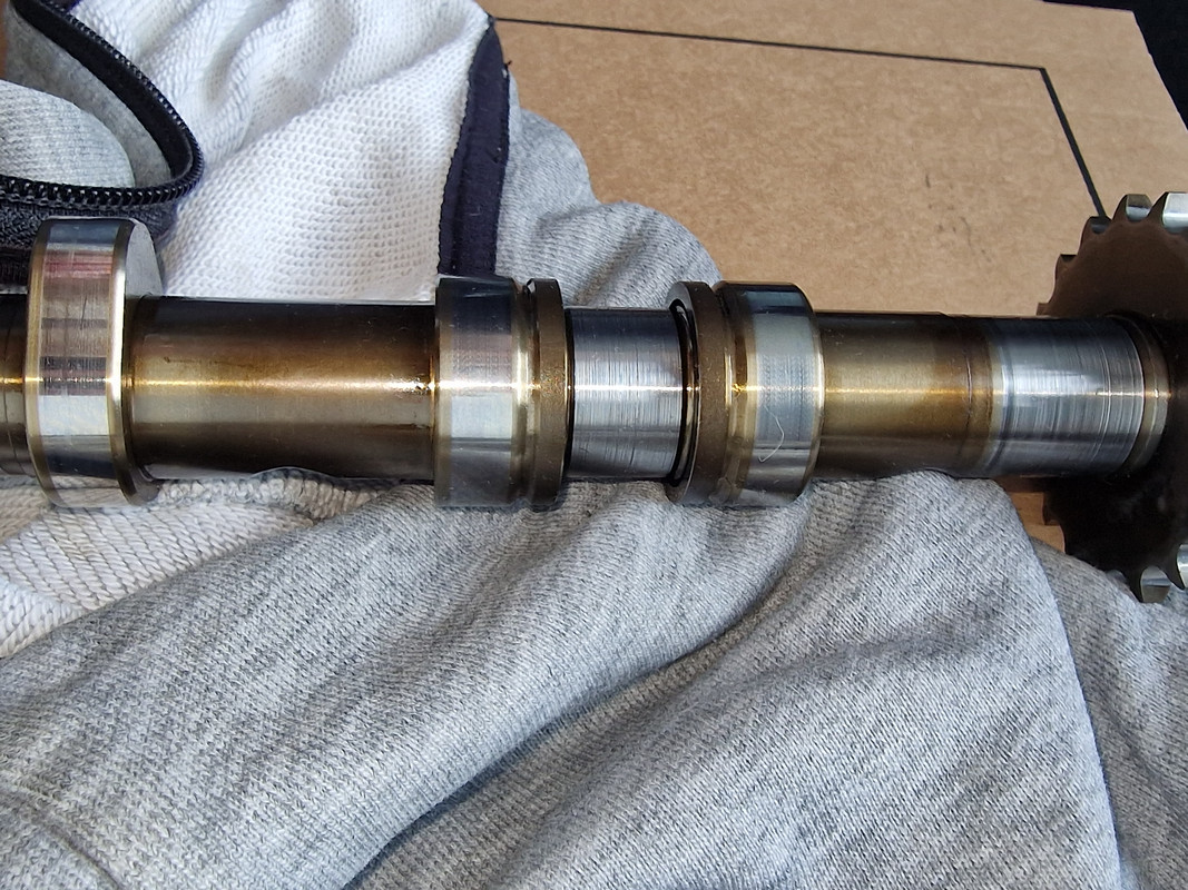

Managed to get an intake cam for €50 off a friend whose vrs had low oil pressure and left a nice hole in his block. Initially was sceptical because of the oil pressure possibly wrecking it but it looks much better than mine.
Here's some pics
Now, I know it's not perfect, but I think it's multitudes better than mine. But I'd appreciate if you guys could weigh in and tell me what you think.
Part number 06F109101B, pretty sure that means a bog standard original AXX/BWA cam.
Cheers  :happy2:
