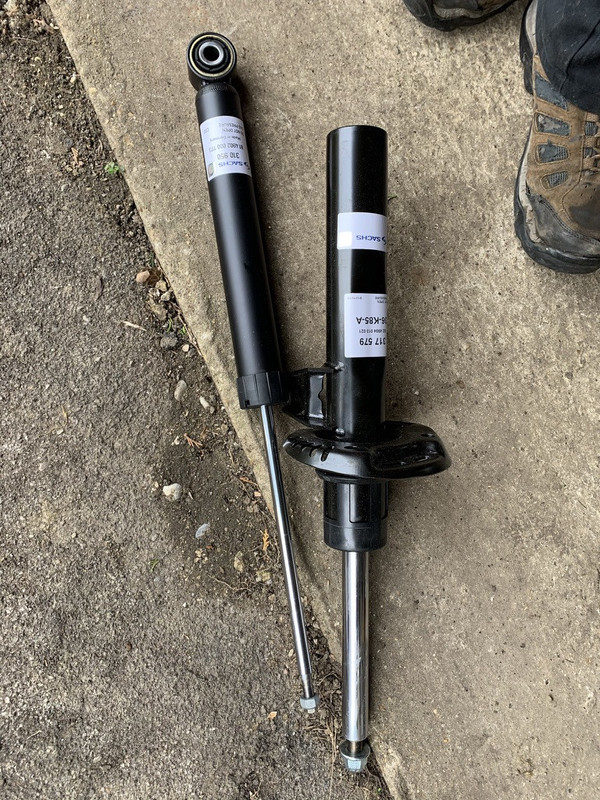

I had my 75k mile Gti done at the weekend.
Sachs OEM front and rear shocks
TTRS Topmounts and new bearings
OE Quality balljoints and droplinks
Feels more planted and less rattled over rough ground now. It was not too bad before to be honest but thought it was time to do it. It was not a bad idea after all as front nearside was weeping.

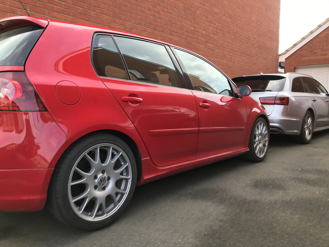

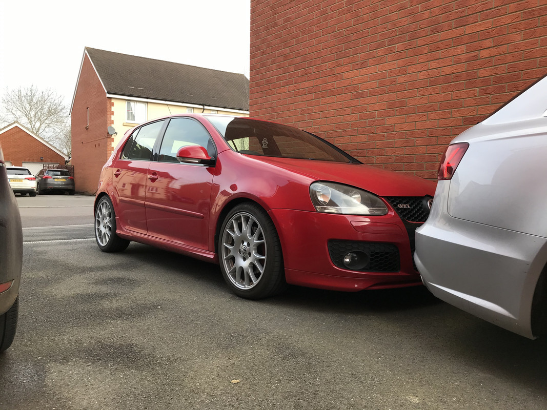

The picture above is of my ed30 with the correctsport line kit. It is barely any lower than it was before? Don’t understand why people keep saying it makes it too low 🤷🏻‍♂️

« Reply #54 on: March 29, 2021, 03:47:54 pm »
You're right, it doesn't look any lower - I don't understand that. I've currently got sportline springs (which should be the same as yours) and the drop over stock was very significant. Not happy with it and fancy new dampers so going for the pro kit instead.

« Reply #55 on: March 29, 2021, 05:55:48 pm »
The Eibachs with B4s make the rear lower than yours, front is the same. Definitely too low for me so when I can I'd like to swap them out for springs that are near stock.

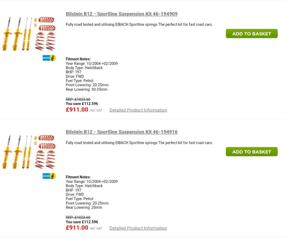

I've had two springs flagged in my last MOT so considering a full refresh whilst I'm at it. I think I've found why the B12 sportline has some mixed reviews. Seems there's two part numbers, one with 20-25mm front drop and 30-35mm rear drop. The other has 20-25mm front drop and 20mm rear drop.
Perhaps someone with some more knowledge will correct me? But if not I'm hoping this will help someone out!
