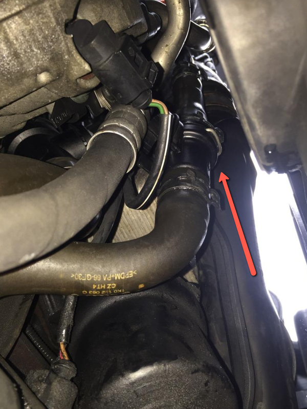

« Reply #3 on: March 04, 2024, 04:36:11 pm »
Mine used to fluctuate between 70 and 90 or on colder days never get to 90.
The inline one that I mentioned was stuck open. Once I replaced it, the car got to 90 in about 10 minutes and stuck there.

« Reply #4 on: March 04, 2024, 04:38:33 pm »
Looking from under the car up.

« Reply #5 on: March 04, 2024, 09:59:56 pm »
Thanks @mjmallia, appreciate the response and the picture, really helpful.  I'll investigate this and see how I get on.
