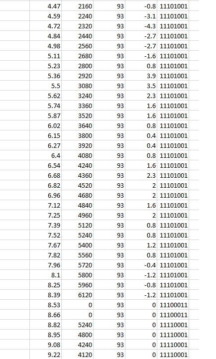

Ive done a couple of pulls and here are the results
First column is time stamp than engine speed than cooland temperature than lambda control and last is basic setting
I dont know how to post the excell file here
But as you can see there are 2 instances where the sensor seems to have drop outs?? At least I'm guessing thats what it is.
I've allready ordered a new one since it wasnt too expensive (around 30 euros).

Yes can see a couple of drop out where the rpm drops to 0, crank sensor should fix it, let us know

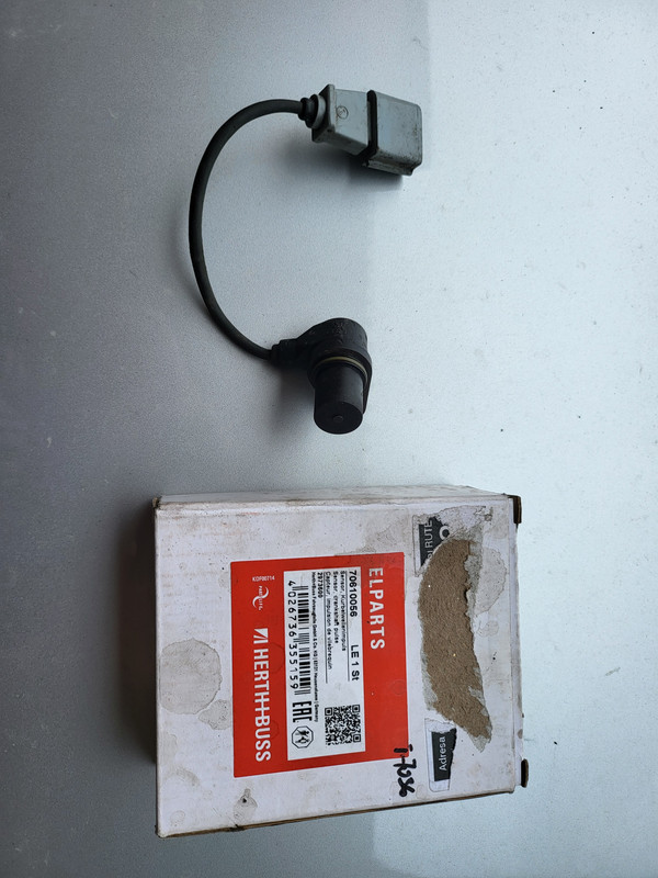

I have replaced it today but didnt have a lot of time to do the testing. Did only a couple of hard accelerations hitting the rev limiter and seems to be ok. Im not yet 100% sure its fixed but ill report in "some" time and let people know.
Btw visually there wasnt anything wrong with the sensor
