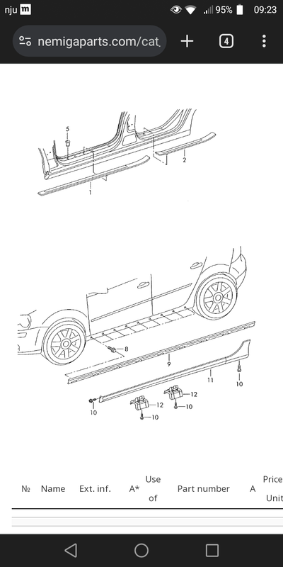

Thanks for that, but it looks like they're not using the part I'm talking about anyway.
Im talking about parts 8 and 9 here:
I wanted to reuse that instead of just glueing the skirt on, but maybe I'll just end up leaving it out.

« Reply #7 on: April 13, 2024, 10:34:56 am »
 Fitting part 9 would have to be perfect or the skirts wouldnt sit correcty. OCD would kick in  :scared: :scared:
Yeah exactly, that's why I was hoping there is a version of the sills pre drilled or at least marked for the screws, it would be near impossible to get it right without.
