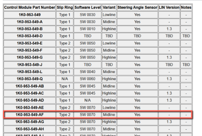

Hi everyone, i decided to retrofit highline instrument clusters and MFSW but my module is 1K0 953 549 AF. I looked at rosstech but i dont know which module i need to buy. Can someone help me with this? Sorry for bad english :smiley:

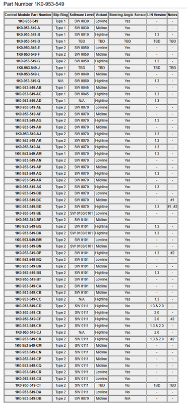

What cluster PN do you currently have.  The early highline ones ending 970, 971, 972 (to 2006 roughly) can be reprogrammed DIY style
https://www.mk5golfgti.co.uk/forum/index.php?topic=91363.0
The steering wheel modules vary also, and have to match to the slip ring.
So one ending in G, AG, AJ, AK, AL etc
You need to get a highline type 2 module that is, as yours is a midline type 2
http://wiki.ross-tech.com/wiki/index.php/Steering_Wheel_Control_Module_Versions

1K0-953-549-CH should work.
I am still searching for those clusters so i dont have it right now. Someone mentioned that module ending with CH should work but i see that CH module is other SW versiom than mine, does that matter?

SW version if the same or newer is fine.
So 1K0-953-549 CH should work?

CH command strong prices for some reason. The AG and others in the list will work just as well
