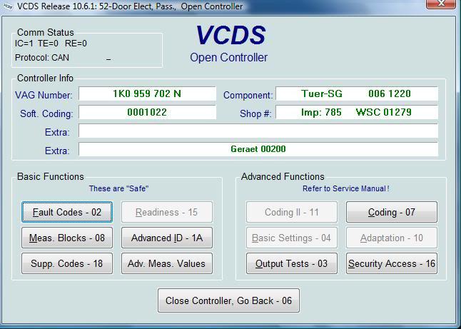

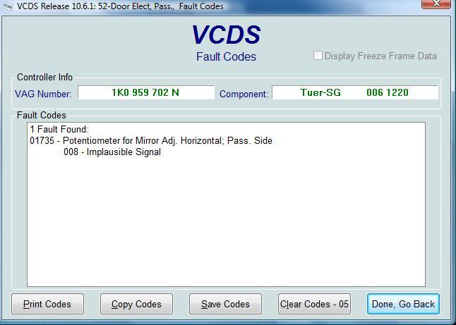

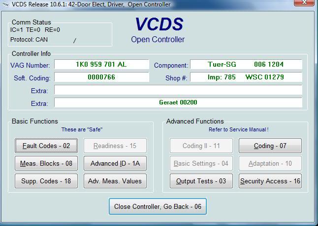

hi hoping someone can help me, ive retrofitted folding mirrors a while back and only just recently bought a new switch (mirror ) from vw so i can actaully select the fold option
i went into vag-com and added the coding 4096 to my drivers door first and when i clicked save
it said coding rejected error 31 request out of range
so im pretty stumped to as why it wont accept the coding, because my part numbers are the same as the above for both sides driver and passenger
are my door controllers not got the folding capabilities
images included of my door controllers#
DRIVER
PASSENGER
im also sure my mirrors are folding
because took the mirror cover off and could see extra wires coming out of where the turn mechanism is. part number for mirror are
driver side
1K2 857 502 EB 9B9
Passenger side
1K2 857 501 BL 9B9
rang the dealer up and gave him the part numbers and he said there are not coming up in the system,
also the date on the part number sticker said 10/04/2006 so they are off the early models
i wanted to find out that if they are actually folding mirrors not just mirrors with entry lights, but like i said im sure they are folding as my standard mirrors didnt have the extra wires that go into the turn mechanism inside the mirror( lol hope i make sense) and i may be wrong, cos when i bought them off ebay he said they are folding
anyways enough rambling cos im sure ive confused someone
any help is apreciated!

Re: Retrofit electric folding mirrors?
« Reply #110 on: October 22, 2010, 11:05:03 pm »
Ive got them on me Edition and they are pretty naff TBH... they dont fold in that far and you have to manually fold them! If they folded up when you turned the ignition of id like them more!

i also had this problem.  i changed every part of the mirrot assembly out and it made no difference.  i eventually twigged that the mirror that came off had extra wires that enable the mirror to tild down when in reverse.  as far as i can see this would make no difference to the mirror glass motor but it was annoying me so i replaced the mirror with a new one specific to the controller on the window regulator.  the fault vanished never to retrun.  cant really explain it but check if the mirror you removed has about 4 extra wires, or see if your new mirror tilts in reverse with the switch in L.
if the window regulator wont accept the coding as you increase to 4096 etc then the regulator does not support that feature.  the only way is to replace the regulator.

« Reply #113 on: October 23, 2010, 09:50:10 pm »
i transfered all the wires from my old mirror to the new mirror and the error disappeared, i also transfered the black circle box type thing that the mirror sits in, but i just cant get it to dip, the regulator can dip because the dip worked on my old mirrors, so just need to find out how to reprograme the mirror so it can dip again, need to adjust the mirror manually so it can learn that position, but unsure how to do it. also i thought my regulators would be able to fold, cos the part numbers are the same as the guy that has folding mirrors from factory, so im unsure again! lol, thanks for any help
