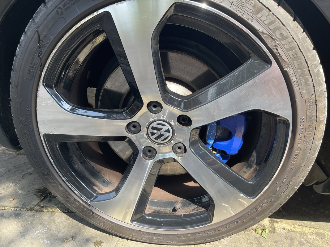

I had been worrying about fitment for a while, specifically about dust shields/backing plates and caliper clearance with my 18-inch MK7 GTI rep wheels. Turns out I didn't need to worry about either  :grin:
Mk8 R / S3 8Y OEM dust shield were purchased for £75 from main dealer and I had been considering R32 rear shields for £55 from Darkside, before reading other forum posts saying the originals can simply be bent back... and both ended up totally unnecessary!
Everything bolted up using stock dust shields with no issue at all. The Mk5 GTI shields were retained front and rear - 2mm bend adjustment of the front shields and about 3mm bend on the rear shields. Everything looks factory and you wouldn't know they'd been bent without being told.
The only downside of all this is I don't have the cooling benefit of the Mk8 R vented shields - time will tell if that's a big factor or not.
Wheel clearance is about 5mm, so we're good there too.

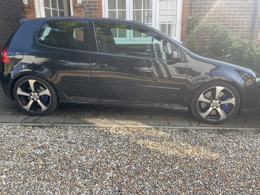

Pics of the final results. Unfortunately the garage forgot to take pics of the fitment as requested, so these will have to do:
