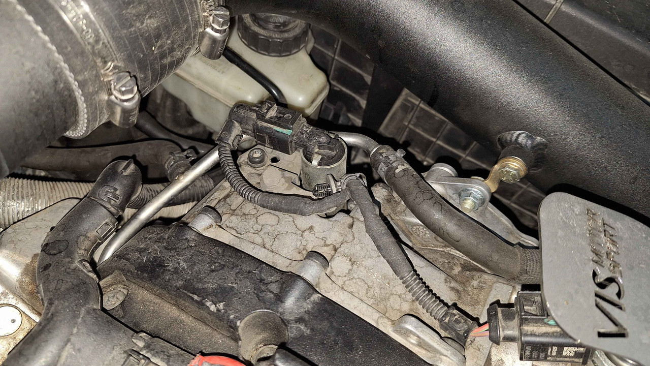

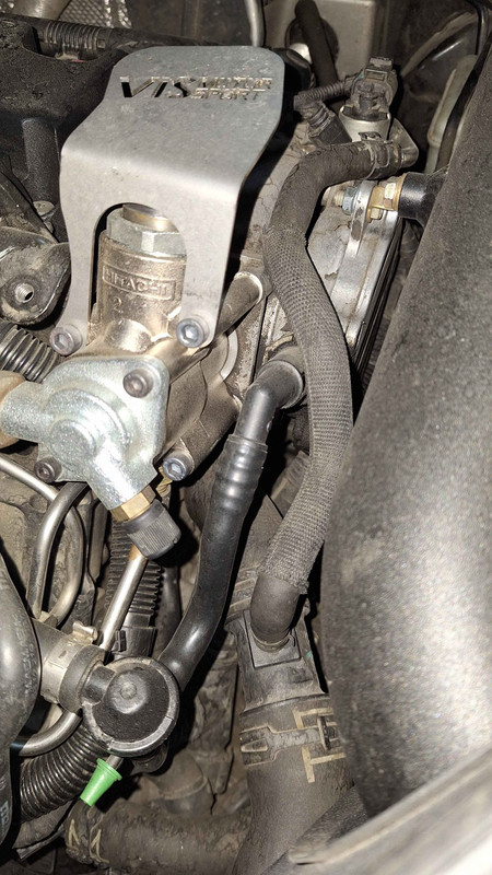

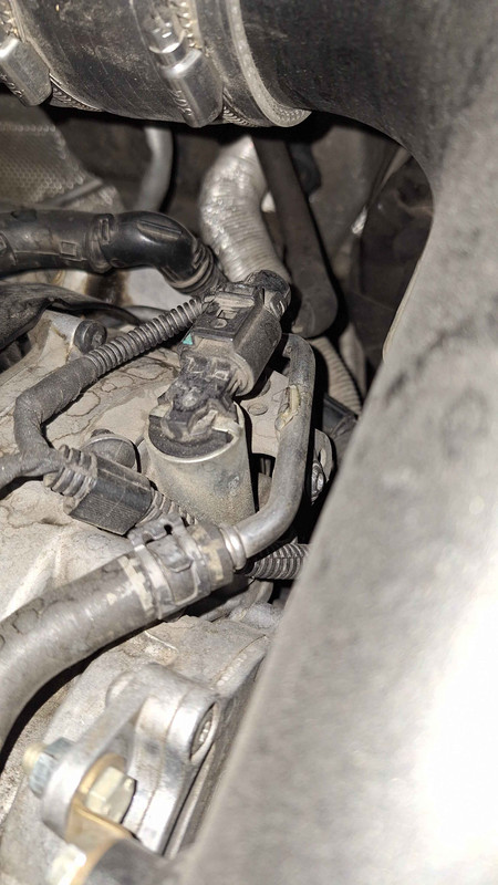

BWA here. This is how the pipe sits normally.
Mine is also leaking but it's so little it's not even worth looking into it. I've replaced the seal the goes into the VVT housing but there's another rubber seal right under the flat metal cover of the vacuum pump. that's the one that usually starts leaking.

Hi, Thanks for your reply and for sending the photos. The leak on mine is very minor too, probably from the outer seal as you say. I guess its not worth the trouble of changing the pump out just yet.
thanks again.
