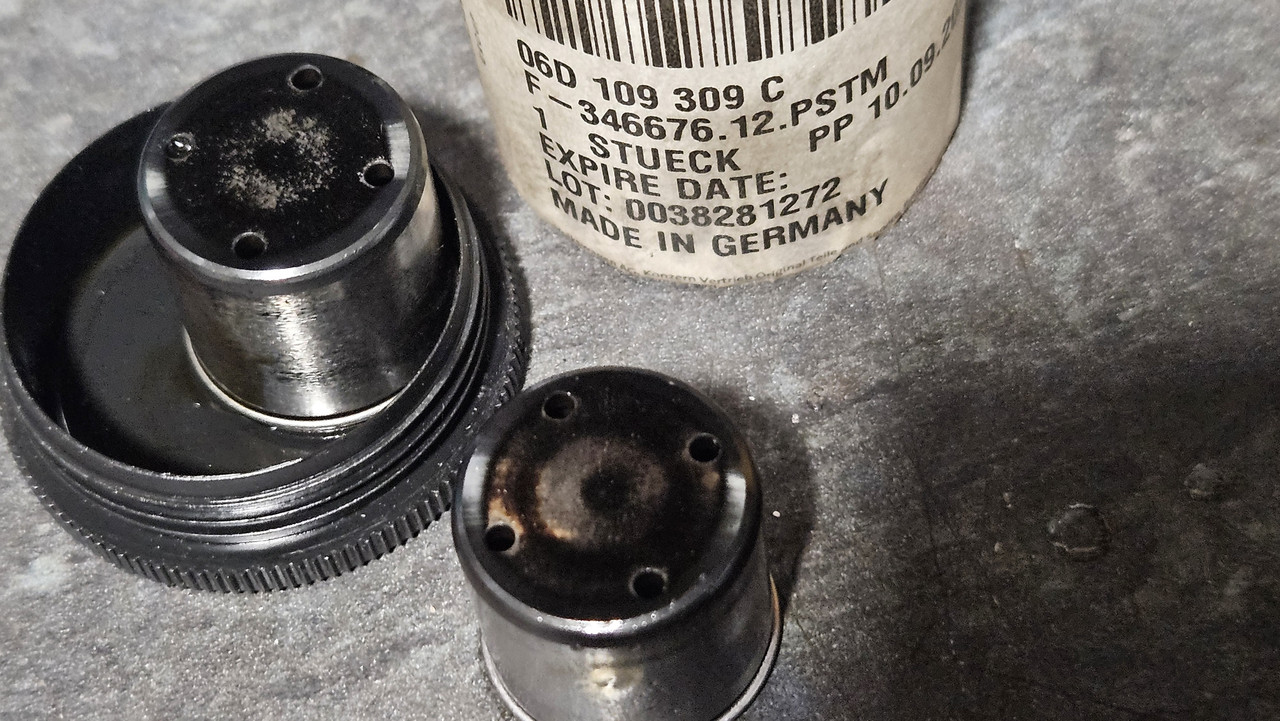

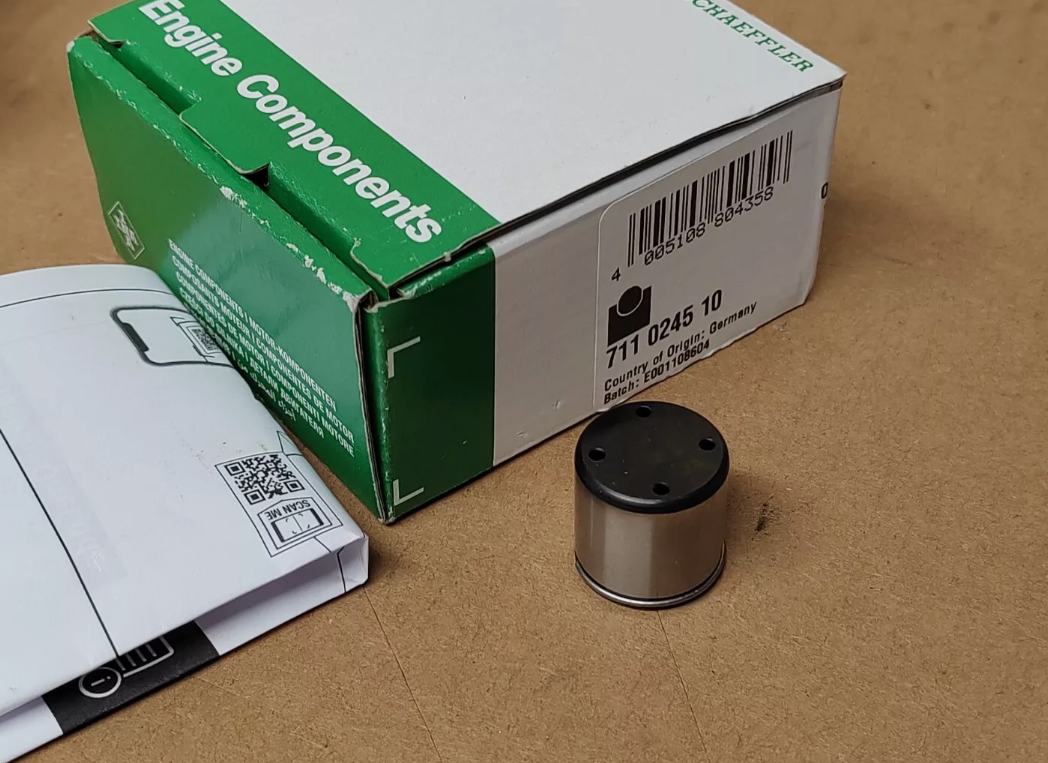

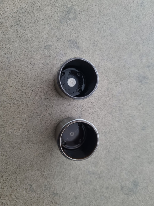

I did not see any markings on the inside of the INA one, but my genuine one does not appear to have any markings on it that I can see either (I have two old genuine ones from TPS).
Local indi for the INA, this is the only pic I have

Ok thanks for the info. The INA one I received had no markings but it also had no box, so even though the supplier confirmed it was INA I was dubious about using it, that's how come I ended up with the other ones.

The INA ones I used didn't have any markings from memory, but as stated previously, they are who make them for VW.

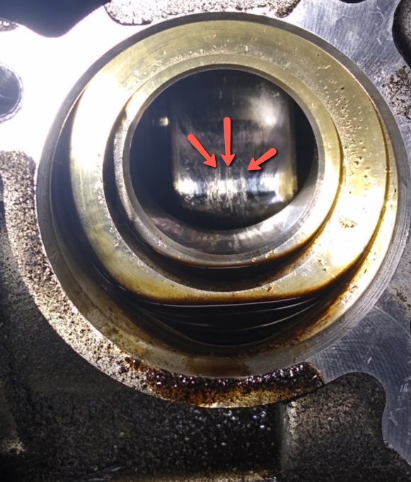

Your intake cam has had it.  The irregular scuffing on the cam follower is a big clue to that, along with the rough finish on the lobe itself. Normal follower wear is a small and uniform round patch in the middle that gradually spreads out over time.

Here are my old genuine followers since getting the car in 2017, to show normal wear.
Left: 2017 to 2021
Right 2021 to 2024
« Last Edit: September 02, 2024, 08:18:15 am by mjmallia »
Mike
South Coast

That looks like normal follower wear  :happy2:

I'm thinking that my follower must have been replaced already, because that follower surely didn't cause the wear to the cam. I'll probably do about 6000 miles in a year so I'll check it next year and see how bad it is.  I'm really disappointed about the worn cam, I  didn't expect any wear at 75,000 miles. I just hope I don't need to replace the cam anytime soon.

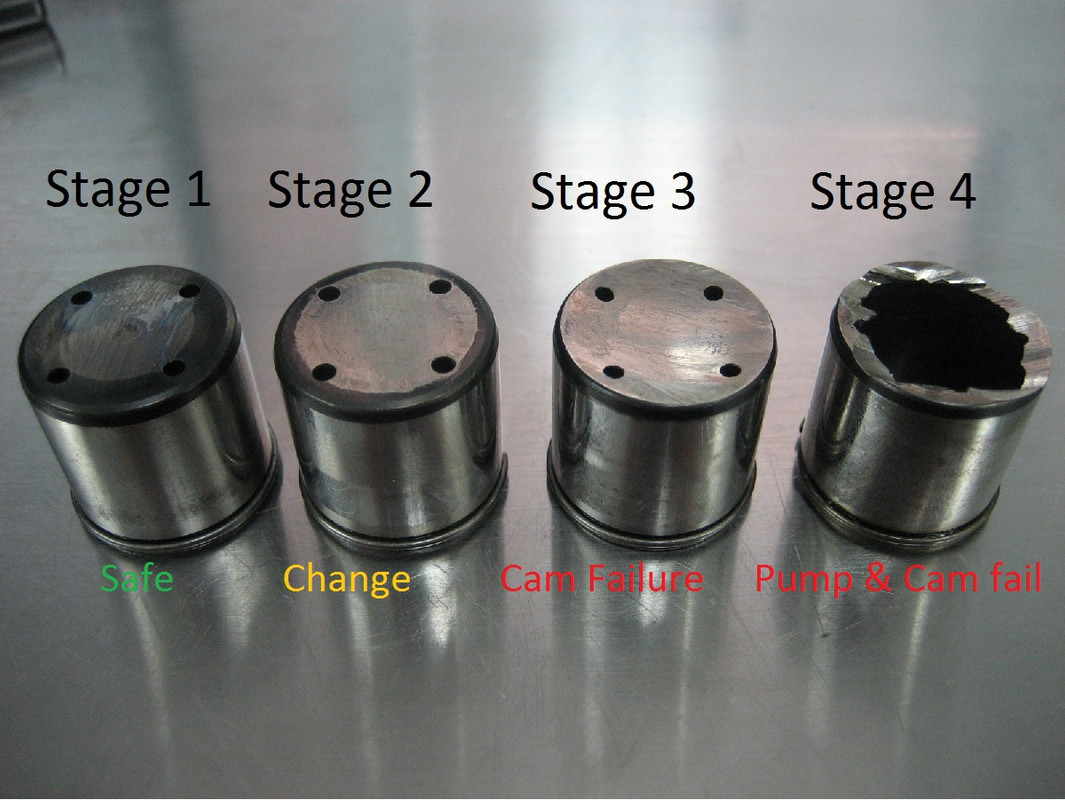

It looks like a follower was worn through, and the pump piston was then hitting the cam and the remains of the follower scratching the cam also.  The three grooves align with the piston cap worn flat to me.........I could be wrong
Stage 4
End cap of the piston.....this is a new one
Your cam
A new follower was slapped in and the car sold on most probably.
« Last Edit: September 06, 2024, 10:24:38 am by mjmallia »
Stage 4
Your cam
That sounds like the most probable explanation.
I had a look at the end of the pump expecting to see wear, but it must be quite hard as it actually looked like new.
That wear pattern on your follower is because the cam lobe is worn and not rotating the follower.  It's basically just beating on it.  The round centre wear mark that gradually gets bigger indicates a healthy follower spin, and therefore cam lobe.  A worn down cam lobe also reduces HPFP pump lift, which if it gets bad enough will cause fuel rail pressure fault codes.
I'm going to check it next year, hopefully it won't have caused too much damage by then.bI know it's not a hard job but I don't want to be taking the hpfp off every five minutes. I also need to keep an eye on the oil, I'm not sure if the hpfp has an internal leak. The oil in the hole where the pump goes smelled a bit petroly but the oil on the dipstick smelled normal. Actually as I just typed that I've just thought if that's got a small leak it could be diluting the oil on the cam which would give me my wear problems.

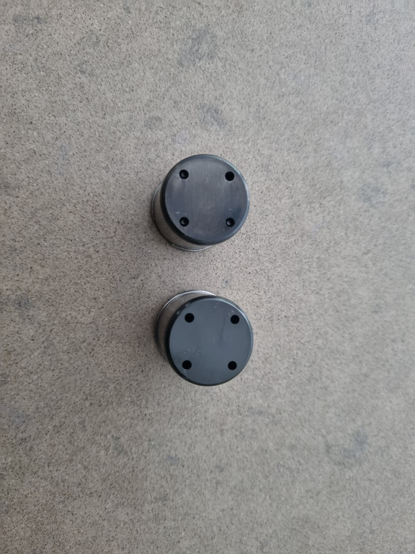

Finally got round to replacing the cam follower.
I purchased the kit from here in the end:
https://www.coverdalecarparts.co.uk/product-page/cam-follower-kit-2-0-tfsi
Genuine VW one with upgraded stainless steel bolts.
It was first done at around 45k and now done at 96k miles. It wasn't in too bad a condition. Some pics
« Last Edit: October 07, 2024, 10:40:26 pm by Rado16v »
