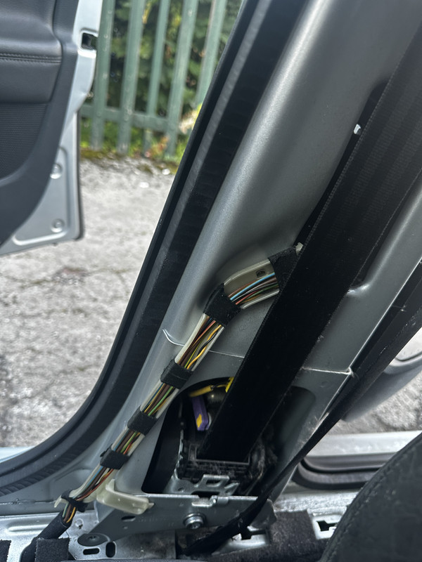

I took apart the interior panels and checked for power going to the exterior connector and I got 0 power excluding the black wire and a yellow/green wire. However it wasn’t constant it was a fluctuating power. (Only checked drivers side)
Could it possibly be a coding issue ?

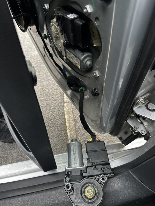

I had replaced the window motor from another working golf, this brought no luck. I’ve ordered a door lock module and will see if that is any help.

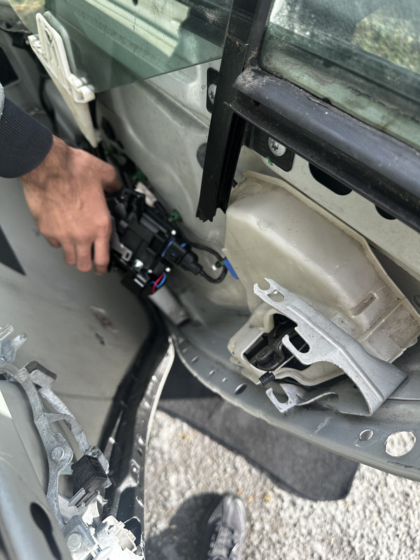

Today I replaced the door latch however this brought no joy, I also tested the plug to see if there was any power.
