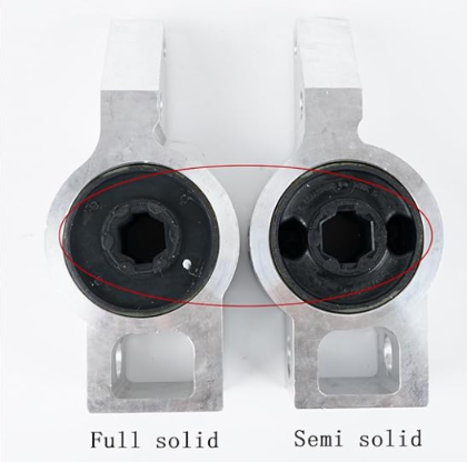

S3 bushes have no voids like the GTI etc
I used these to replace my original voided ones:
https://www.amazon.co.uk/gp/product/B006DHY58W/ref
« Last Edit: October 21, 2024, 11:25:52 am by mjmallia »
I have those fitted. That's what parts dealers here call reinforced bushings.
