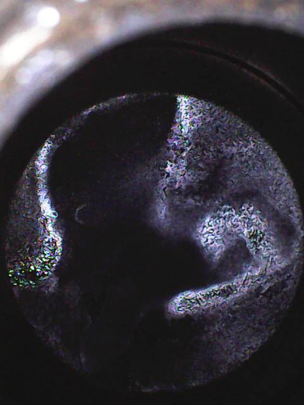

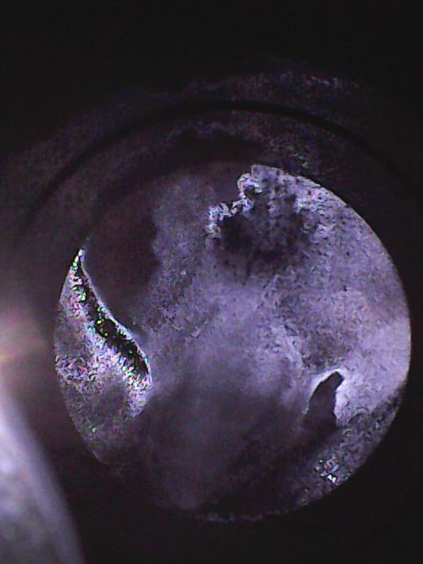

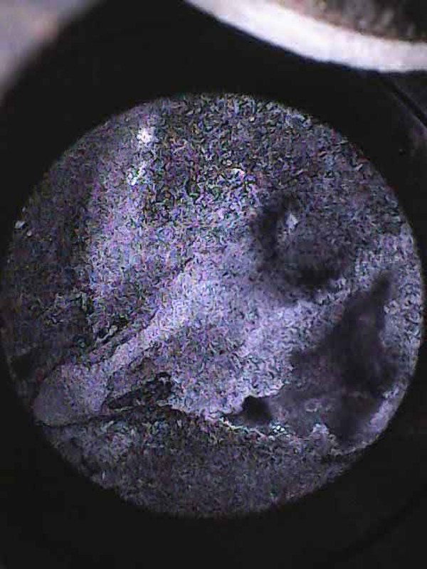

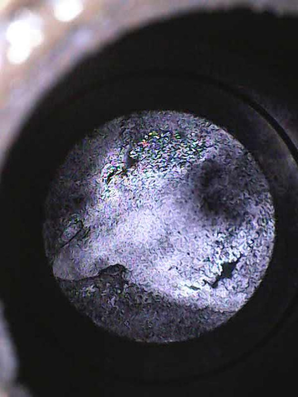

Forgot to add, when I replaced the spark plugs I poked my little borescope camera down the holes and took photos. Is there anything to be discerned from these? I think cylinder 3 does look a bit darker than the other 3 cylinders, but the spark plugs all had a healthy colour
Cylinder 1
Cylinder2
Cylinder 3
Cylinder 4
