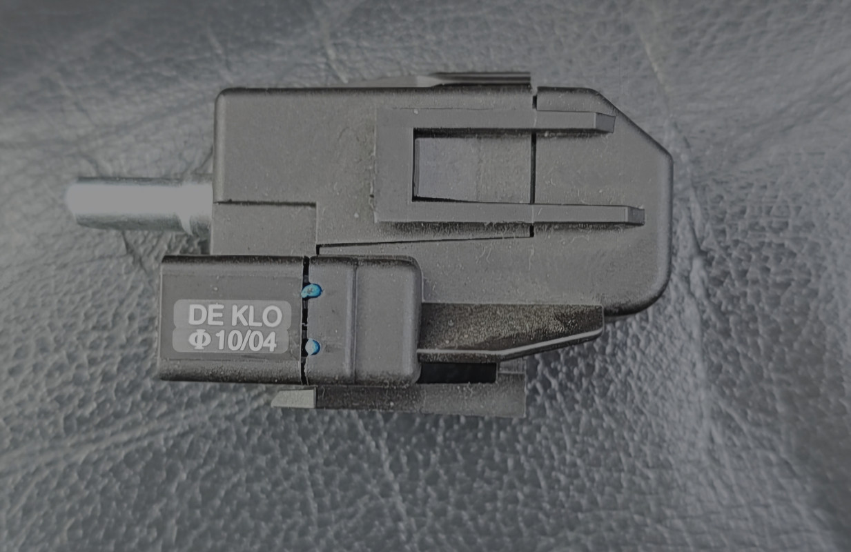

Almost 4 years later and I finally solved this issue.
I took the cover off from around the ignition and the ignition barrel lock sensor fell out!!!
Put this back in and no more flashing on the dash!
Hope this helps someone!
I've attached an image of said sensor!
