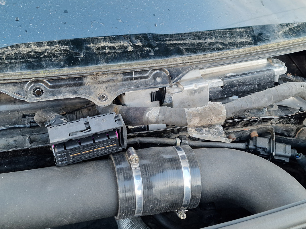

Managed to get the ECU connector out but not remove the ECU. Anti-theft cage in the way and I don't have the right tool to remove it.
5V (pin 1 MAF connector) leads to here
Missing 12V (pin 2 MAF connector) leads here.
So no issues with the MAF wiring before the ECU. Anything else it could be?
