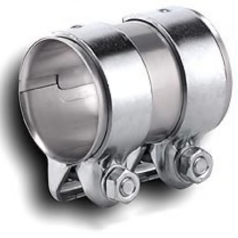

I just cut a section of my downpipe out and before each test I fit a sports cat. I use these kinds of clamps to hold the pipe/cat in place:
