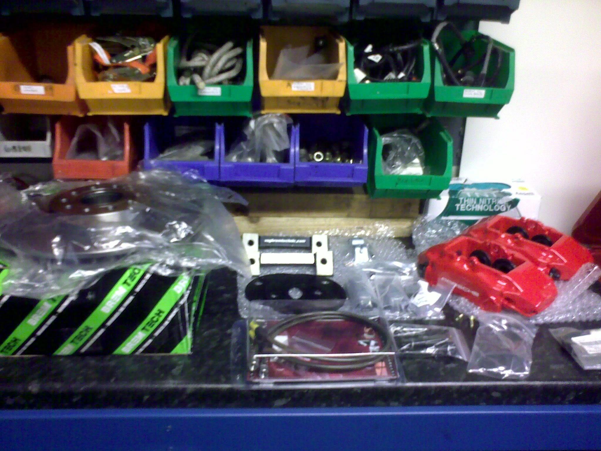

Its been fun getting it this far, heres the kit awaiting fitment at ADS in Preston, Dave Massey there does a good job on installs he's got a knack of getting a good pedal be it single/4/6/8 pot which isn't always the case with other installers, he's also a revo dealer so he's going to give Joes car a once over prior to the mass forum exodus to Shermoney next week.
