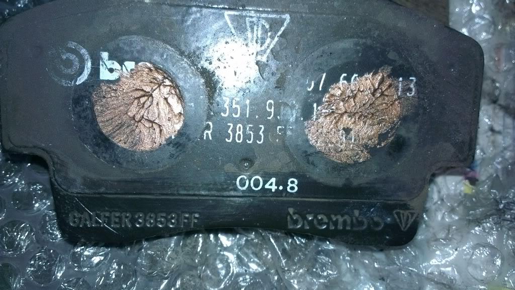

Look what arrived last week  :party:
Now they are with Dave B getting a refurb :happy2:
Does anyone have any experience with these pads?? I cannot seem to find out very much regarding them.

I am running mine without the antirattle shims at the moment and without squeel. Whereas the shims helped with previous pads, I have got away with a good dollop of Ceratec on the back of my current pads and a bit more on the piston faces for good measure  :happy2:
That picture above shows copper grease on the back of the pads - get that wiped off if you have not already done so and use Ceratec. The petroleum based copper grease rots away the rubber dust seals on Brembo calipers.
I found that any squeel fades away with a couple of weeks of use; if not I found that another reapplication of  Ceratec sorted things out despite there being plenty there in the first place.
PS those Galfer-made pads are good!

yep they are OE pads.... Galfer ONLY make for OE manufacturer.
The give away is the "351" in the part number....that refers to front brakes on Porsches
That's an OEM set of £190 brake pads you've got there pal
Copper grease also does harm to alloy parts (calipers) and ABS sensors.
Pagid Ceratec and other ceramic based antiseize pastes are ones to be used on current cars.
