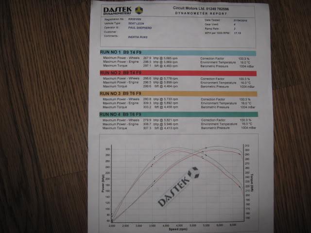

I had two intakes lying around and could'nt decide which was better. My original Forge intake flowed better than my Dbilas up-top and sounded much better (IMO) but my Dbilas had better throttle response, especially at motorway speeds. I wanted the best of both worlds. I had an idea, grew a fat pair and tried it.
And it worked.  :congrats:
Throttle response is much better, mid-range pulls very hard and top-end is nice and smooth, and it sounds much better than my Dbilas or Forge when they were on there own. Lots of Darth Vader noises.
Power band is very, very smooth and the car flows over 215gs at the maf. This intake will be following me to big turbo land.
Intake temps do not rise above 20*c and is at 17*c at redline.
Here is Dyno run note how smooth it is.  :happy2:

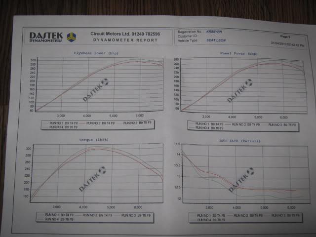

I find it puzzling why your peak torque appears to occur at around 4.4k rpm on a k03.  I would expect this with a bigger turbo and not a k03. :confused:
My peak torque occurs at around 3.2k rpm with a stage 2+ revo map allbeit with higher numbers than your results.

bacilus is right about the peak torque as well.

@acespizee : thats some intake thanks for sharing , well done  :happy2:.
In terms of 'smooth' curves though thats just how the software is set, easily manipulated, the graphs from various tuners vary widely in the smoothing applied (as do power readouts lol).
however the numbers seem very healthy. Have you been on any other dynos
I dont know why my torque peak is so high, i am Revo stg2+ aswell. I have never understood why some people make more torque than me. Car starts to shift at about 2200 rpm. According to boost gauge i get full boost around 2500 rpm. low-end seems really healthy on the road. I guess my car likes power more than torque. Still enougth to come on boost quicker and take down sub-360 bhp Evo's.  :happy2:

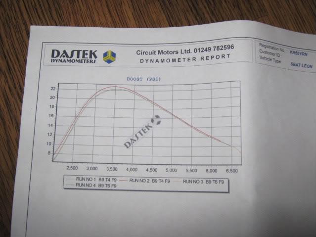

I wonder if you ever logged your requested and actual lambda with vcds as, IMO, after looking at the AFR on your printout, you should probably run your fuelling a tad richer i.e. use F8 instead of F9.
My understanding is that the RR AFR tends to be slightly leaner than when logged using vcds.

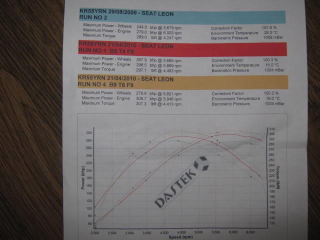

Thanks mate, I usually take the car to TSR in bridgewater. The car produced 203 bhp and 212 tq stock. With just Revo stg2+, Dbilas, S3 I/C, SFS hoses, Forge DV, 3" ATP decat D/P to stock cat-back, Neuspeed pulley and HPFP the car made 280 bhp and 290 tq on there MAHA Dyno.
I then took the car to circuit motors by Castle Combe for a dyno day with some friends from my car club Performance Bristol. The car produced 279 bhp and 289 tq on the Dastek Dyno, leading me to beleive it to be very accurate. I also had a sligt boost leak as i was only getting 18 psi.
Next added Forge I/C to S3, Milltek cat-back to my ATP D/P, Custom intake, RS4 Valve, PCV to exhaust, fixed boost leak and i now have 308 bhp and 307 tq on the same Dastek Dyno.  :jumping:
I will post up:
I had more torque low-down before but, the extra more than compensates. :party: :party: :party:
I heard VCDS aint accurate for lambda on the Vortex. I hear you on the lean runninig as the dyno operator pointed this out to me aswell. I have been running fuel setting 8 since, i have not logged to check yet tho.
I may even start running fuel 7 but will log first, thanks for pointing that out tho mate.  :happy2:

Nice work mate and nice figures...  :congrats:
BUT, you stated this in your first post...
I made a custom Twin set-up and i make 308 bhp and 307tq (280 bhp at the wheels) on my K03 along with my other mods, up from 280 bhp and 289 tq with Dbilas.
Twin-intakes definetly work.
Then this..
Quote
Next added Forge I/C to S3, Milltek cat-back to my ATP D/P, Custom intake, PCV to exhaust, fixed boost leak and i now have 308 bhp and 307 tq on the same Dastek Dyno.  :jumping:
I'm not sure you can claim over 20bhp difference over the 2 intakes when you have added all the new bits and more importantly fixed a boost leak  :confused:. Which could make a difference of 1bhp upto who knows...  :surprised:
