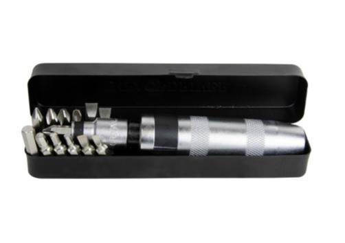

Got one of these today.
Halfrauds Pro Range Impact Driver & Bits
I've got the same one Carl, good bit of kit  :happy2:

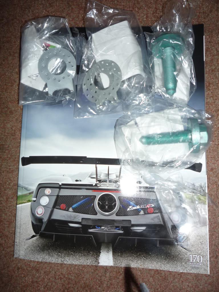

Bolts, spacers & this months EVO

....Eeek!! I thought at first that you had bought a rear end body kit!  :scared:
« Reply #2643 on: April 21, 2012, 10:22:01 am »
^^^ looks like you've bought 4 spacers, you'll only need 2.

There are actualy 4 spacers Rich, top and bottom on each side  :wink:

What Damo said  :happy2:  Note the very slight variation in design

ahh ok.. i stand corrected!  :happy2:

Those bolts don't look right.  Too short and the washer is massive.

Whats the part number on the bag for the bolts?
I wasn't aware of using the washers on the bottom too, or are they for the top of the consoles?

Upper & Lower is all i know, sorry.
N 906 460 01 Bolt Hex HD Combi
Washers are 7M3 499 349 (& 349 A)

Bolts you need are N 908 235 01 going off the old thread Mandy started.

^^ these are the bolts i fitted last week, noticeably longer with a much thinner washer than the ones you have Mike..

The bolts do look very different from what  ive seen removed from my subframe before & the ECS pic in mandys thread

Where did you hear about fitting the shims to the bottom?  I can't see them being needed as the movement is between the subframe and the body.
