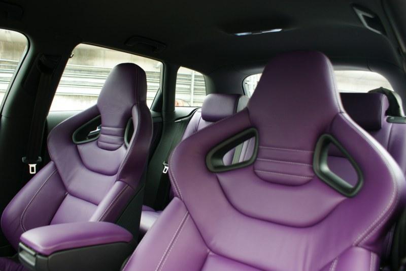

Still working on gettin the heating/airbag working, but bolsters are all working.

N8 you lunatic, first time Ive seen them. Awesome!

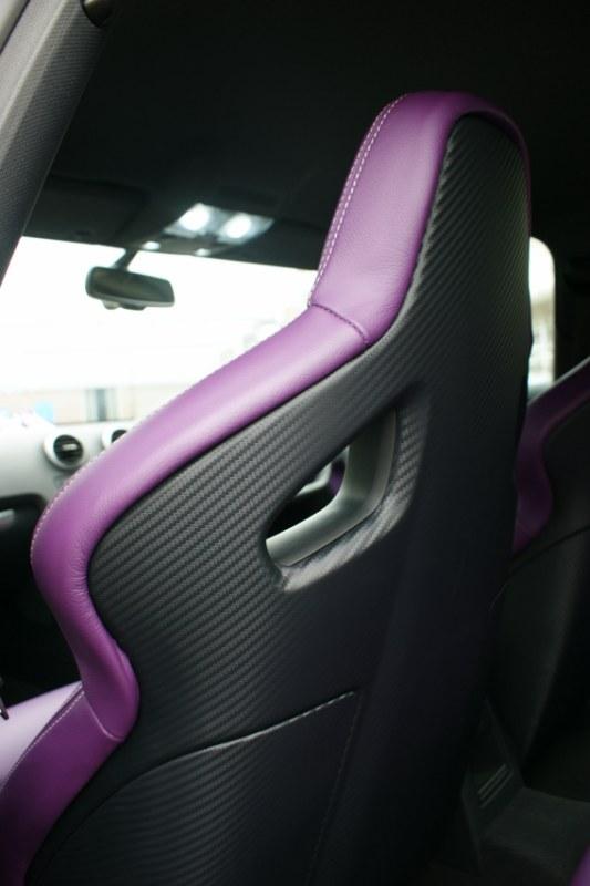

n8kow who did the carbon wrap on the front seat backs ?

I wonder where you got the idea of carbon vinyl wrapping the seat backs  :wink: :wink:

A signwriter from Manchester did mine, I can pass on his number if you like!
@ Red Robin. John told me about your seat backs, and I needed to sort out my door trims and something for the air ride controller. So 3M was the best option really, and as I was having the re-trim, perfect time for it to get done, yours inspired me for sure  :happy2:
