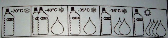

On the bottle, it shows a pic:
Is a 'drop' a litre of water?
I've been using neat until I saw the label and it said "concentrate"!!!

i took each drop to mean one part.
so -70 is neat
-40 2 parts washer fluid 1 part water
-35 half half
-16 1 part fluid one two parts water
no frost 1 part fluid 4 parts water
i normally use 500ml per tank.
thats enough really, it smells nice, melts ice in england, and gets thru road salt.

bear in mind VW will want you to buy loads of this stuff!
i think 1 part fluid 4 parts water is more than enough in england. thats 600ml in each tank of fluid. meaning out of a 3L bottle, you would get 6 full washer bottles
