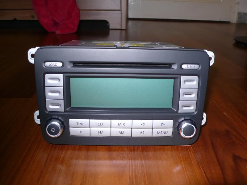

Does it look like this: -
or similar without the silver buttons?
Offline coop
  • Posts: 66
Re: Stereo Upgrade options
« Reply #4 on: June 28, 2010, 06:32:13 pm »
similar but with silver buttons, just like this:
Offline Moschops
  • -Given: 118
  • Posts: 1958
  • Edition 30 No 2275
« Reply #5 on: June 28, 2010, 06:59:47 pm »
^^^^^^.....RCD300...^^^^^
RNS510 is your best bet if you have the scheckles to buy one.. :happy2:
