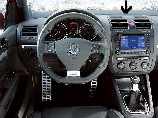

Hi Guys,
I have a rattle coming from the cover on the dash for the top, centre vents.  The arrow on the picture below is pointing to the cover i mean:
Not my car, just using this as a reference.
Does anyone know how to safely remove the mesh cover covering these vents?  There is a small gap and i thought I could gently use a flat screwdriver head to lift it off.  Unsure if it clips off or not.
Any help would be appreciated.
VW Edition 30 DSG, 5 door, RNS-510

Re: How to remove cover - top vents
« Reply #1 on: July 01, 2010, 04:33:55 pm »
use a plastic tool designed to this and prie it up, very easy with the right tool  :happy2:
Over the top mod list ;o)
« Reply #2 on: July 01, 2010, 04:54:00 pm »
I managed it very easily with a blunt round ended kitchen knife of the dining kind.
There's some info in this How-to-Guide:  http://www.mk5golfgti.co.uk/forum/index.php/topic,14941.0.html
HTH  :happy2:
« Reply #3 on: July 01, 2010, 05:42:00 pm »
Thanks guys.
Will try and buy one of these kits and gently does it......ahhh.....broken cover!  :sad1:  Only joking...should be ok with the right tool!
« Reply #5 on: July 02, 2010, 03:37:25 pm »
I use my fingers, (don't have long nails!) and it comes off pretty easily, but then when you get to taking off the stereo surround area be cateful as the clips on that are stupidly brittle!
