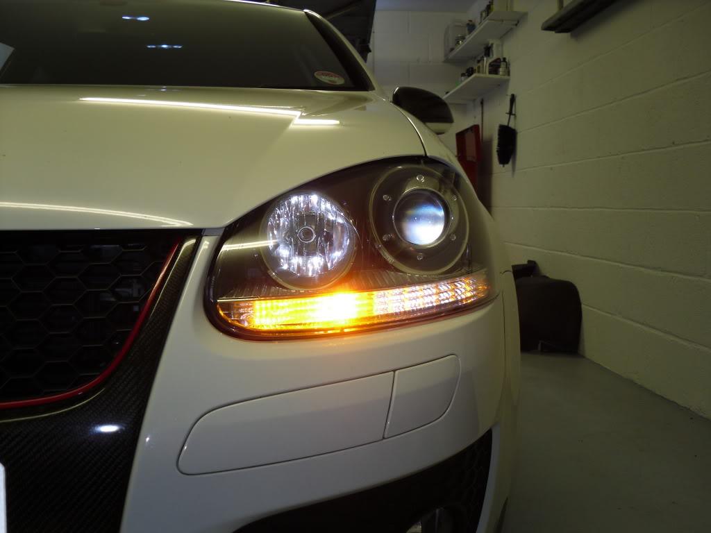

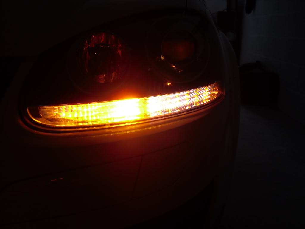

« Reply #34 on: November 12, 2010, 04:48:38 pm »
piccy`s for yall,  there set at 90% brightness in these, which is abit too bright imo

Love them. Although id probably try and set them to dim to 20% when the xenons are on.

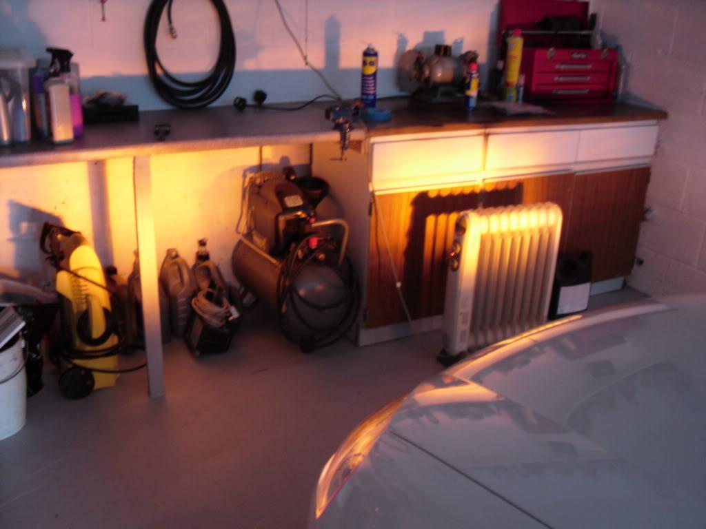

Looks good Brett. I don't think mine enabled properly so ill play with these again tomorrow. Do they work with the sidelights at night? That garage shot shows how bright they can be  :smiley:

« Reply #37 on: November 12, 2010, 08:53:32 pm »
keano - im sure it can be done with halogens
and pete there on whenever the lights are on (side and dipped beam), plus thats only 90% brightness so they`ve got a lil bit more left in them  :happy2:    they didnt activate under what i 1st tried in the coding, so maybe thats what you have selected at the min.  the 1 i changed was further down in the controller  :happy2:

Where they are in your garage, they literally look as bright as average halogen H7 bulbs  :signLOL: I saw them on my HTC earlier but looking on the laptop, they're impressively bright.
