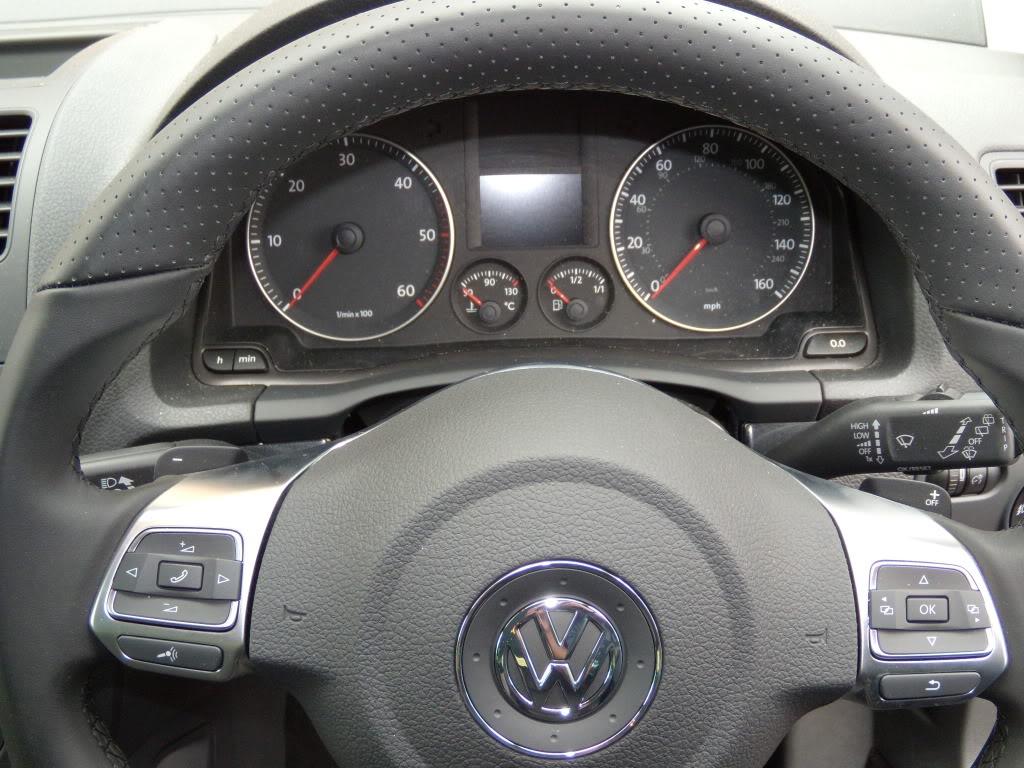

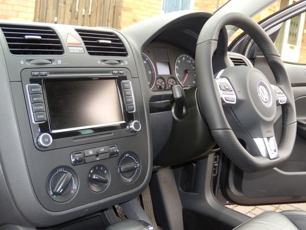

Pics as rquested,

HHHHMMMMM !!!
I like MK6 wheel in MK5 !!!
 :congrats: :congrats: :congrats: :congrats: :congrats: :congrats:

Offline gtlee
  • Posts: 369
Re: MFSW with Paddles retrofit..........COMPLETED AND WORKING!!!!!
« Reply #20 on: July 15, 2010, 01:42:16 pm »
Its nicer to hold than the standard GT wheel and the extras like the buttons and the fun factor from playing with the paddles....makes me feel like a 10 yr old in a toy shop at xmas again! :jumping: :jumpmove:

« Reply #21 on: July 15, 2010, 01:43:14 pm »
Mate it really does look better than the mk5 wheel  :drool: :drool: :drool: :drool: :drool:
