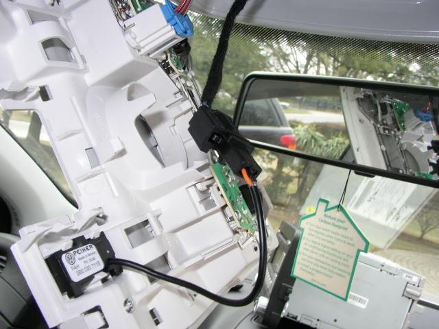

It goes in this part -
Behind one of the 'perforated' sections.
Stu...

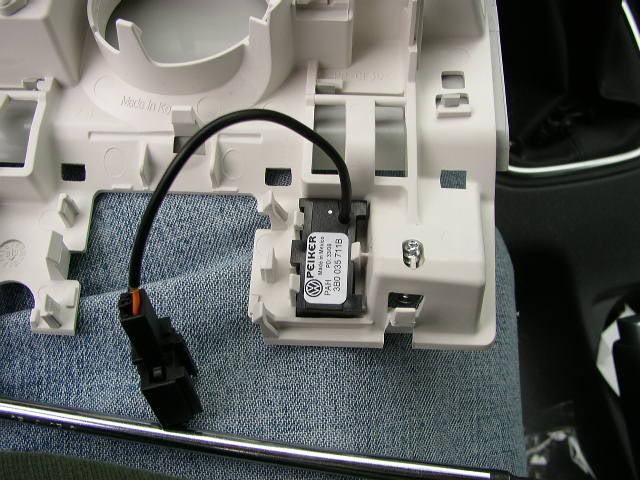

« Reply #6 on: August 03, 2010, 11:38:31 am »
A couple of better pictures from Google Images -
Stu...
