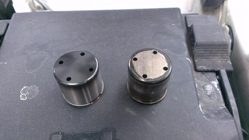

Changed mine last weekend thanks to the OP's guide, took just under 35 mins  :party:
Suppose I had it easier since the LP fuel hose on mine is rubber, however I was quite surprised that almost the whole TC coating was worn from my follower, 2008 GTI @ 50k miles (stage 1):

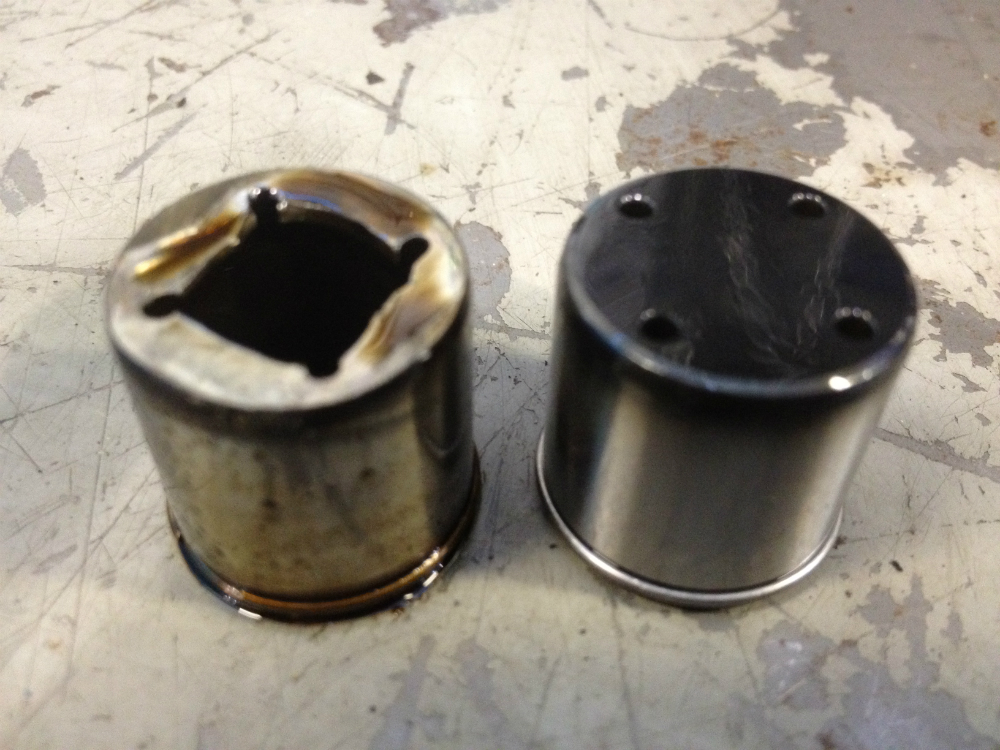

I guess it wouldn't be long before that ^ would be like this:
