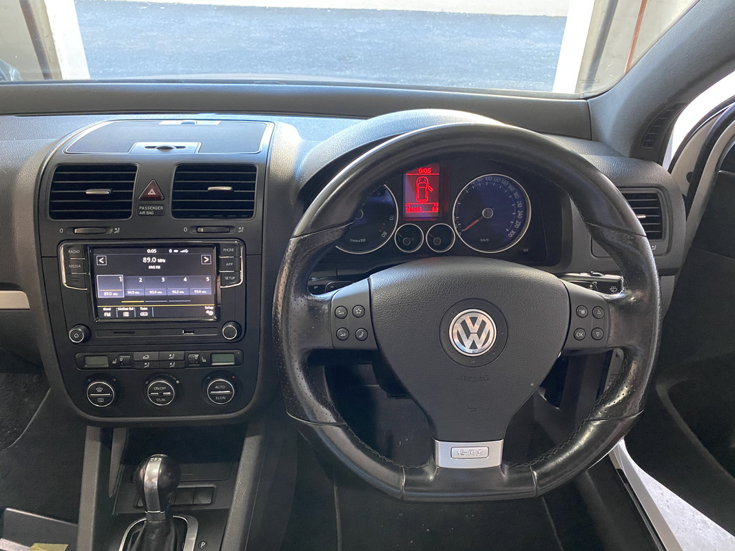

Hey @LC5F!
Bumping this; I just installed MFSW buttons on my 07 GTI. I have Cruise Control, DSG and paddles already, but the buttons don't work. No faults, installed them by disconnecting battery and leaving airbag connected (although it was a pain to work around it dangling there haha).
Buttons light up but no buttons work. CC and paddles work perfectly so no difference in that sense.
What's your take - needs coding, or needs new control module?
Tagging others in case: @Octoparrot @Jons1001 @Gti182

Genuine MSFW buttons? Lots of fake ones about
Offline Grevling89
  • Posts: 21
Re: MFSW Buttons
« Reply #24 on: April 29, 2023, 11:20:52 pm »
Genuine ones! 100%.

Sadly, not gotten around to it yet. It's a bit of a hassle (as well as an expense) to hire a vagcom for a day to code it, and I haven't been scraping in money lately so it's on the backburner for now.
