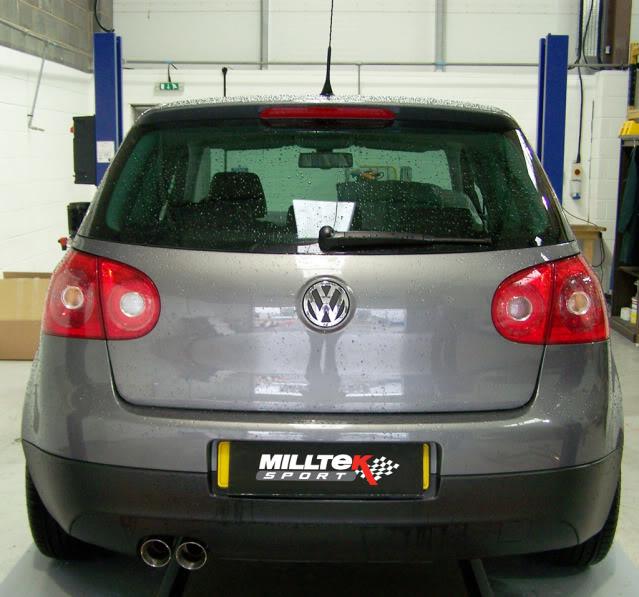

thanks for the advise on the phone Dave :happy2:...the miltek am after is the large bore non cat front pipe with the edition 30 tail pipes,
pm me a fitted price..
