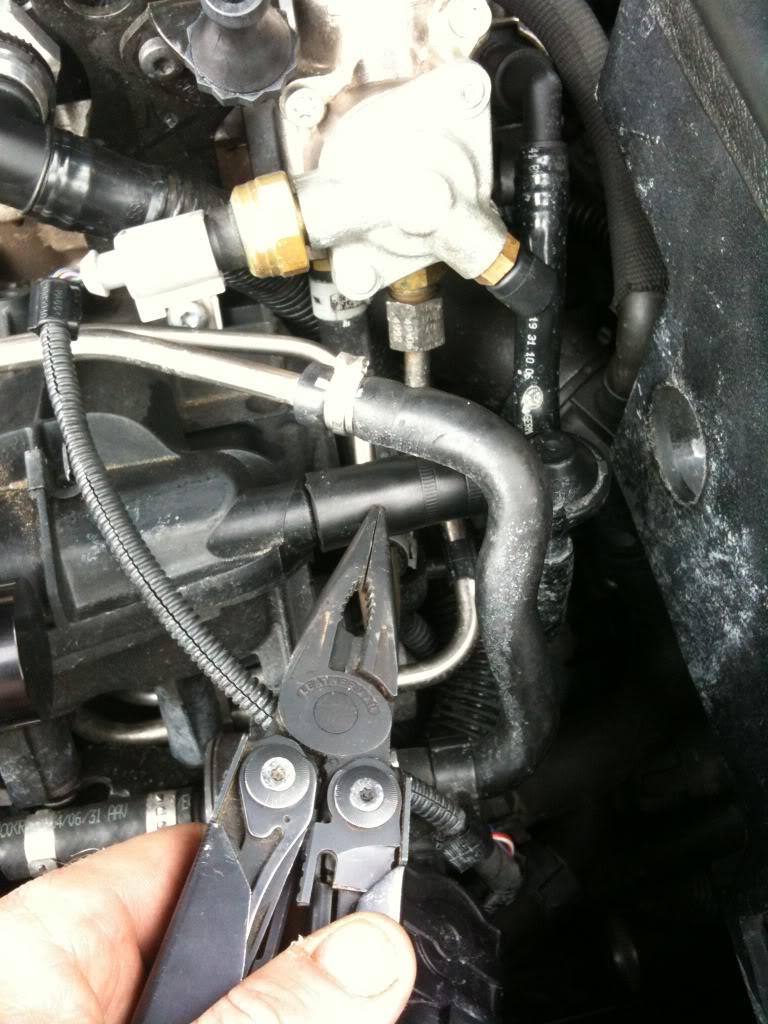

I've had the symptons you describe and a hole in this pipe was the problem.
Offline bacillus
  • -Receive: 453
  • Posts: 6341
Re: Engine running on?
« Reply #5 on: September 16, 2010, 07:07:48 pm »
That's ^^^ the vacuum servo hose.   :smiley:
