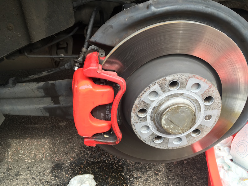

Well it's a bit of a bodge. Doing it properly means sending them off and throwing another 200quid at someone to do it properly. CBA. in a few weeks the will be covered in crap anyway.

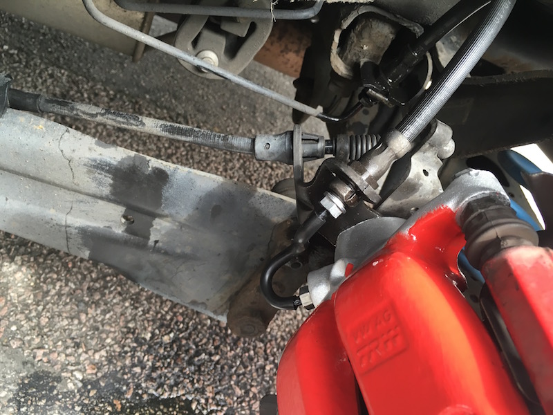

Right.... that didnt go as planned.
I started to do the caddy rears and hit a problem when I couldnt get the hard brake line off the back of the caliper. I could move the but the pipe was fused to the nut. I tried holding the pipe but it was just twisting.
So I have to go to Alex's tomorrow to get some new hardlines.
Also... I noticed that the calipers I bought appeared to be upside down with the bleed nipple on the bottom. A few panics, and Alex confirmed that they are upside down and you have to swap all the brackets on the rear of the caliper over from the GTI to the caddy ones. You can see below what I mean. So where as I presumed that was a passenger side caliper, its not its a drivers side.
It al comes as a relief as I had painted them and there is no way I could send them back.
Hopefully will get them on tomorrow.

f*ckers are on.
New hard lines. Had to pop up to Alex at AKS to get some this morning.
I need to re-bleed the rear calipers in a few days time and give the carrier another coat of paint, then its job done
