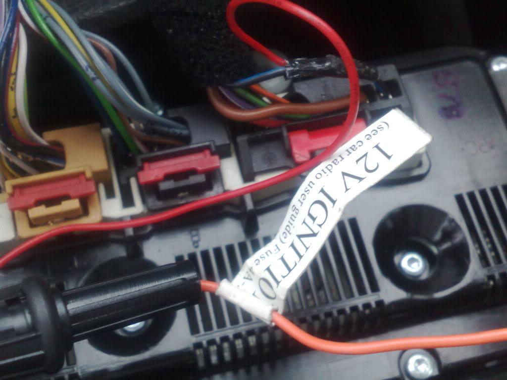

Another ignition switched live is the main power cable to the back of the climate controls... that feeds my phone charger  :happy2:
It's closer to the head unit thatn the fusebox

Funny you should say that Garth I just come across this on my photobucket :happy2:
Big connector pin 20 black/blue wire
Darren
