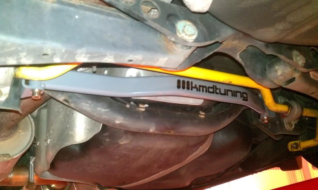

I was sorting through some stuff in the stock room last week and found these and thought it would be rude not to fit them.
Front bar fitted.  It fits neatly under the full length undertray too.
One rear bar:
Other rear bar:
They have made a little difference to the car.  Seems more stable and precise in the corners.
Coilpacks were also done at skoda with no issues.  The tech had been over to bdm before to get some advice on tuning his own car.  I can deffo feel the engine responds better now.

They look pretty beefy Alex. What are they supposed to do and would you notice more difference without fitting the ARB's?

They are meant to stiffen up the chassis.  The rear subframe isn't that beefy as standard.  This bolts up between the weakest points.  It's made of alloy so its light, but also surprisingly stiff.
I thing it would compliment uprated roll bars more than helping standard bars.  We only ever had three sets, one went on a mk6 GTi, one on a Guatemalan Leon race car and the other on mine.  I've not had a chance to push the car in the dry, but I could notice a difference in the wet (i drive quite hard in the wet still).
We don't deal with kmd any more so I can't even sell them.  I would like to make some bars in t-45 rather than Ali as they would be even stiffer and just as light.
Follow AKS tuning on Facebook
