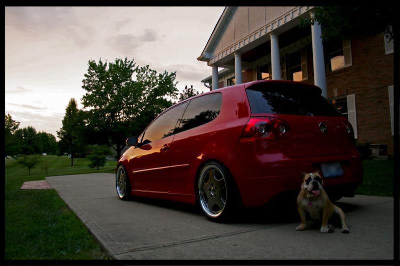

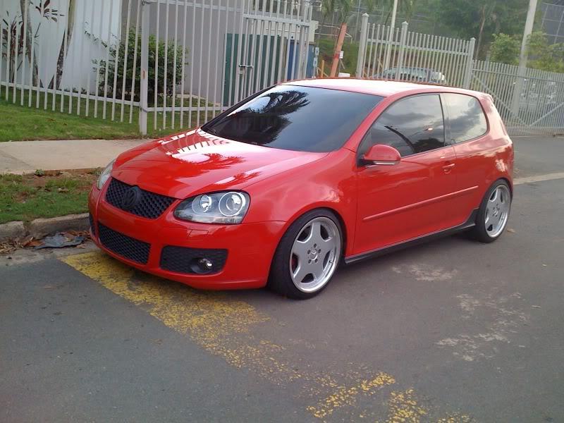

That's because they will either had had the arches rolled or running very stretched tyres with lots of camber.
