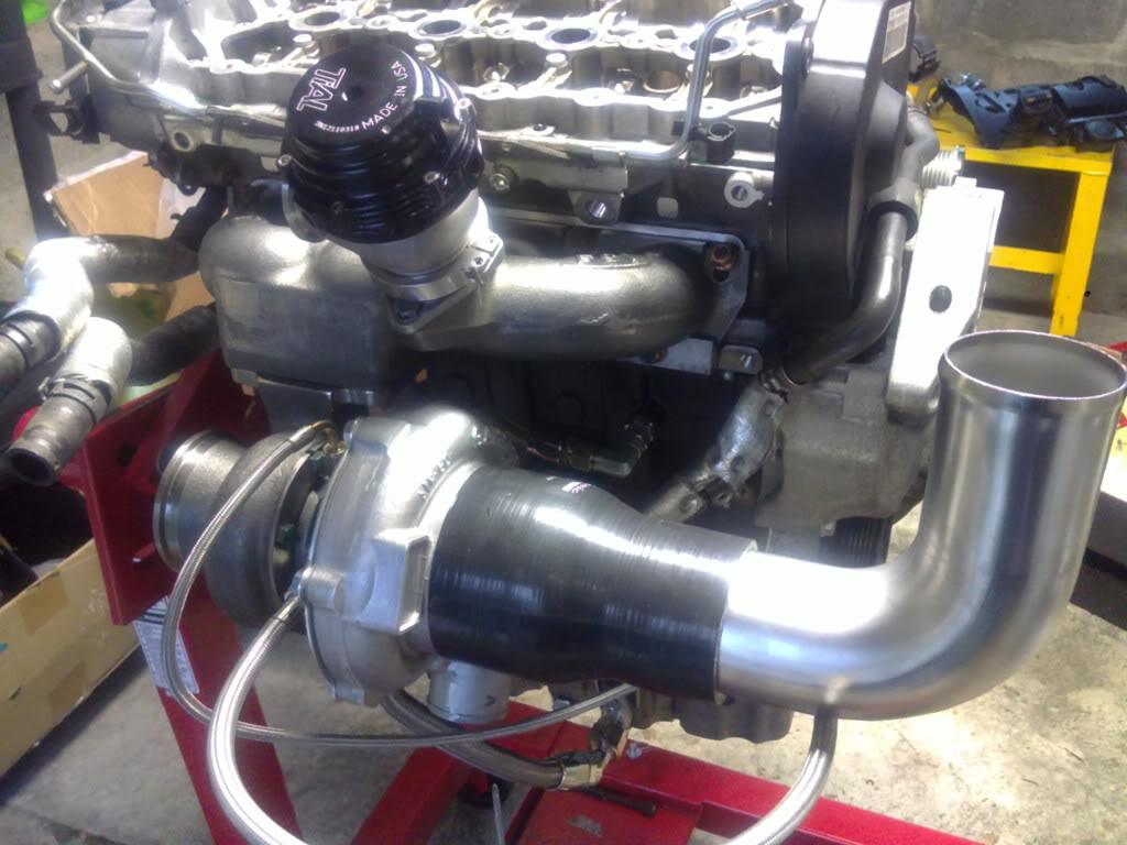

Little question for anybody in the know.......opinions or experiences needed. The big heavy duty coolent line running from the sump is seriously tight bordering on stretched it just makes it and no more could have been doing with an extra 5mm. Has anybody got any experience fitting one or how it should sit? Cheers.
These other parts were strapped on aswell, few little bits to tidy up and need to figure out if the intake will fit as this seems to be a problem area against the brake cylinder try and incorporate the itg somehow.
Been phoning around for views on the mapping side of things today, think ive found the right people................if she runs.  :drinking:

With the atp mani, make sure the surfaces are flat. The ones I have had have needed machining flat as they were miles off.
That oil return shouldn't be that tight.  Looks like they have sent a short line.  I doubt the driveshaft would fit around it either.
If you want a longer line then let me know.  I can get them made within a few days.
On the intake you will have to get something made up to fit as the kit is made for a lhd car.  On a xbow I did a while back I had sfs make a custom silicon elbow which worked perfectly.

yeh reckon you will have probs on the drive shaft , mine is tight on my 28 but not that bad , who you gonna get for the mapping ?
alex how much can you get the pipes made for ? i might be interested ?

Fuk so you mean I need to take it back off again?? That is poor show.
Just had a right good nosey at teffs thread and his looks tighter than mine a little more kinked?
Would you mind me contacting you to organise the intake Alex? Really want something straight fit bolt on easy?
