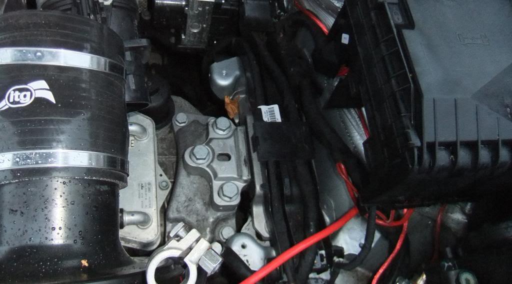

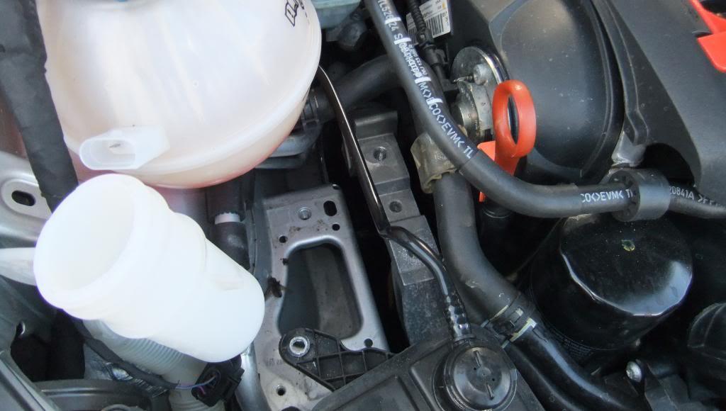

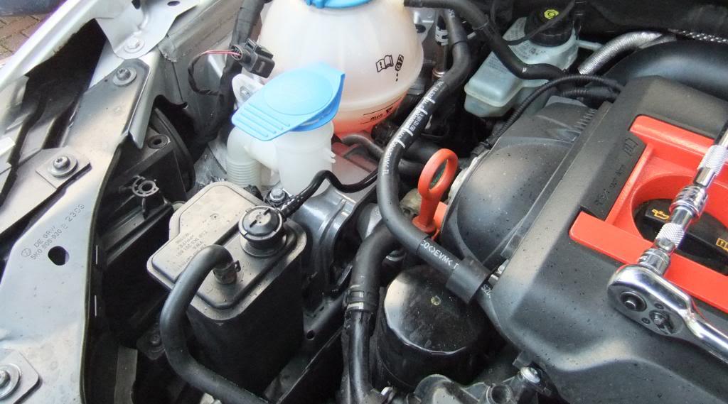

On the drivers side mount I removed the bolts/screws for the washer filler neck, charcoal cannister and expansion tank, then unbolted the side support bracket. Then you can get at the mount, that's unbolted by removing the2 x 16mm bolts and 2 x 19mm bolts.
Pics of the driver side mount: -
This side done: -

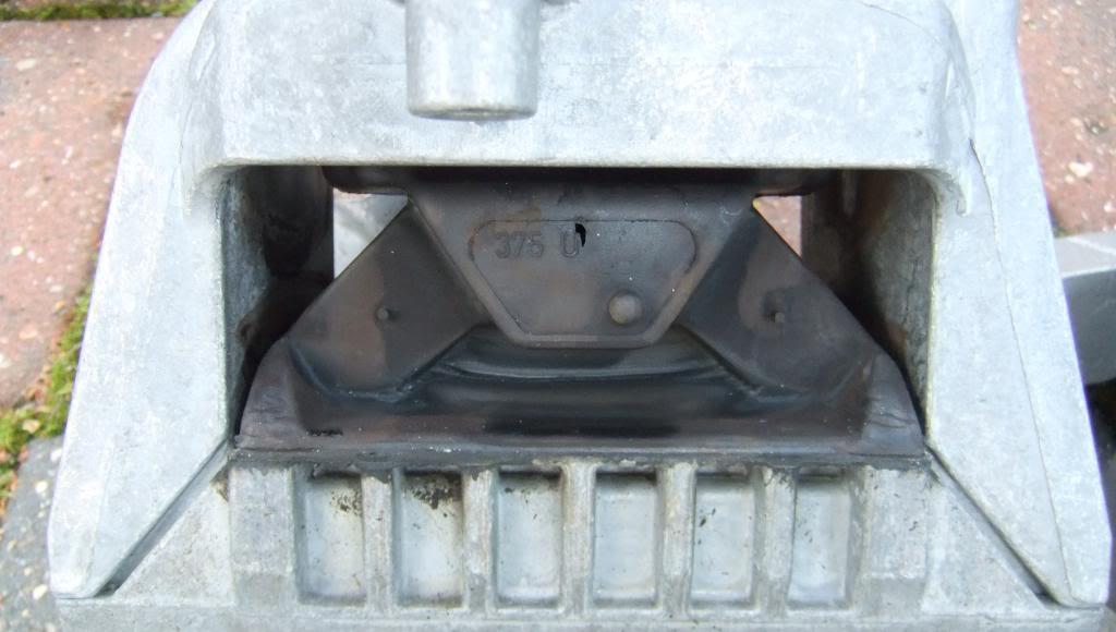

For the passenger side mount, the battery and battery tray (3 x 13mm bolts) need to be removed, then unclip the wiring loom tray the rest on top of the mount. Then unbolt the three 19mm bolts on the engine side of the mount and the 4 x 19mm.
Pics of the Passenger side: -
This side done
HTH  :happy2:
