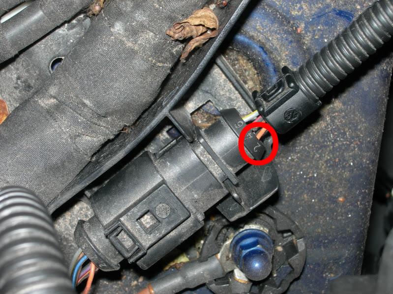

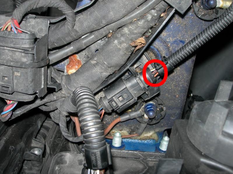

Just been having a bit of a nose round in the engine bay and this is what I've found so far, looking behind the nearside lights..
Pin10 of the headlight connector (grey/black wire) does seem to be the sidelights feed and therefore used for the white 'trigger' wire.  12v when headlight switch set to 'sidelights' with ignition off, 0v when all off.
There is a connector below the headlights (shown in first pic, just to right of headlights connector) which the installation instructions may be pointing to for the red 'switched live' wire.. Anyone know what this connector is?
Pin2 of this connector is the brown/black wire.  I haven't tested voltages on these though.
Is it OK to take feeds to both of the LED control units from this one side?  Forgive my ignorance with all this!

It's really difficult to see what's what in the instructions.
I would use the blue nut in your pictures as the ground, that is a proper chassis ground, for the black wire instead of going to the battery.
On closer inspection it does seem as though they are telling you to use power from somewhere else nearby and use the inline fuse provided.  I couldn't be sure it would be the one in your picture but it's possible.
You've seen where to get the trigger from, the difficulty will be finding yourself enough space in the loom for the scotchlok connector they gave you.
Thanks for that Stu.  It is a pity that the instructions are so unclear.  There should be enough slack to get a connector on I think..

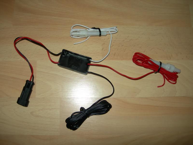

Can you post a picture of the wiring loom?
Do you mean this one that they supplied?

From memory on golfmans(Scott) car one wire went to the pin 10 on the headlights which you have fathomed out another one went to the back of the headlight switch and the other was a ground.
If you have a word with Scott and see if he can send the instructions over to you they are a bit clearer on the hella DRL's in principle they will be the same wiring.
