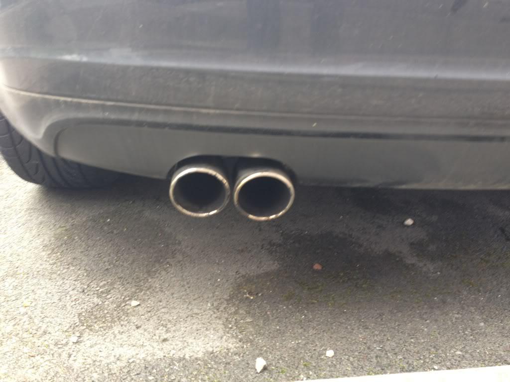

The tips are cartoonishly big which takes away from the stealth look I was going for. It's a taste thing, and no doubt some will really like it:

excellent offer--the tips of the exhaust look like the same as the milly rear ones at 80mm
