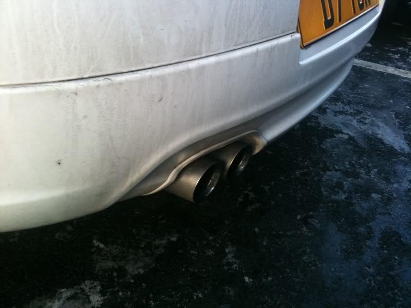

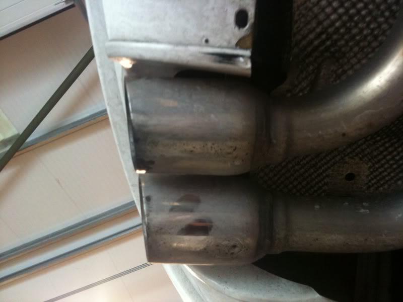

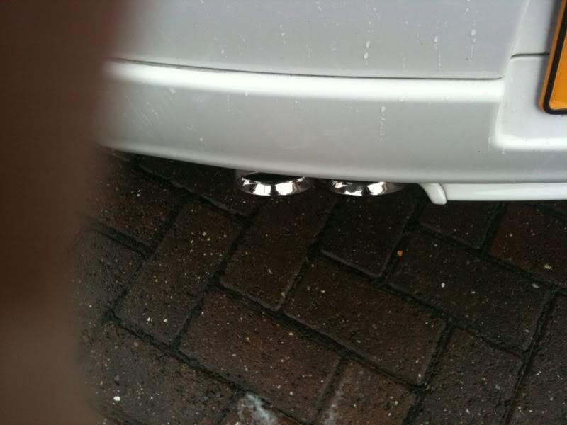

This has been an 'issue' since Milltek started welding on the tailpipes rather than having them on adjustable clamps. If it was a new system then things would have been a lot simpler but as its 2nd hand the history of the exhaust is unknown.
You have 2 options really, you can slide the centre section forward a little so that the tailpipes protrude a little more but then the hangers wont line up perfectly and they will stretch towards the back of the car slightly. The other side effect is that the overlap on the centre pipe only has around 10mm more movement towards the back of the car before the expansion gaps in the exhaust will allow gasses to leak out.
So we might be able to get another 10mm of length on the system, if you want us to try, just call the office and arrange to bring it in. :happy2:
My Eddy had a cat back Milly, and it sat wrong.  With it seated correctly at the front 2 joints (to stop gas leakage) it sat about an inch under the valence.
With it flush at the valence, it leaked from the joint to the OEM downpipe.  Never got it sorted, just a pain in the aris.

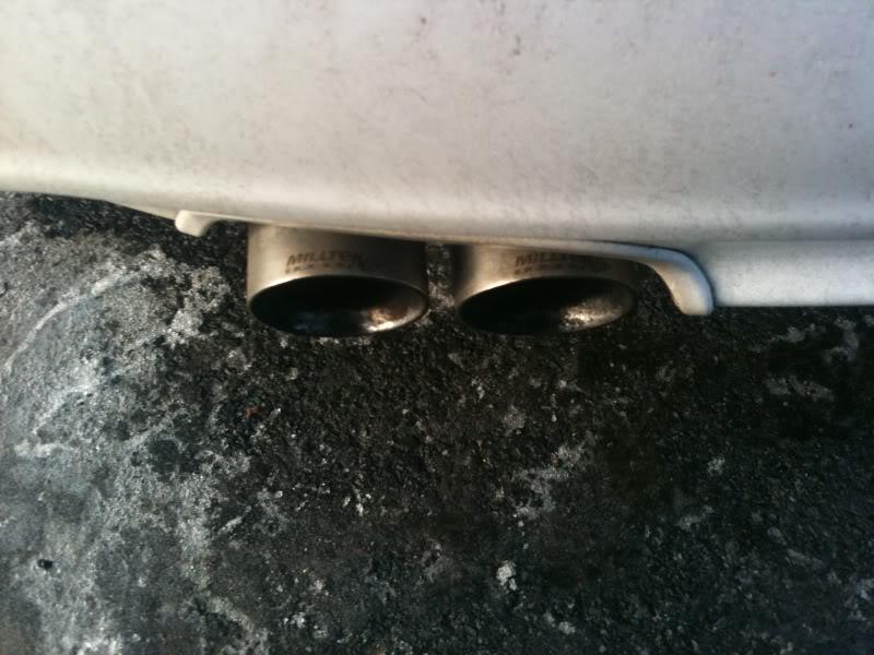

The ED30 tailpipes have always been welded on!  :confused:
Oh and they don't look right that far in, I've never seen any fitted like that.........

quite a  big difference  :stupid:
It could also be down the manufacturing process aswell....

That just needs turning, the left pipe is out too far, and the right ones too far in.
Re-align should sort that out.

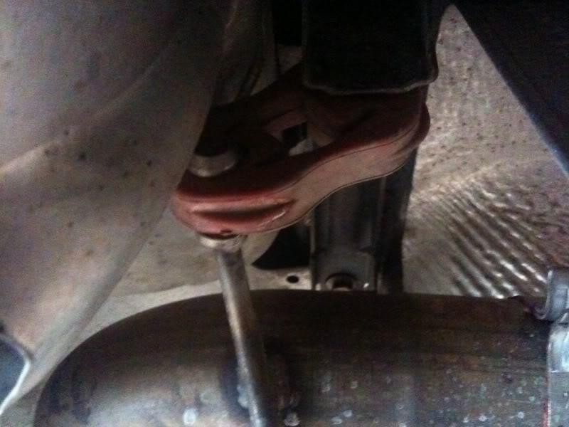

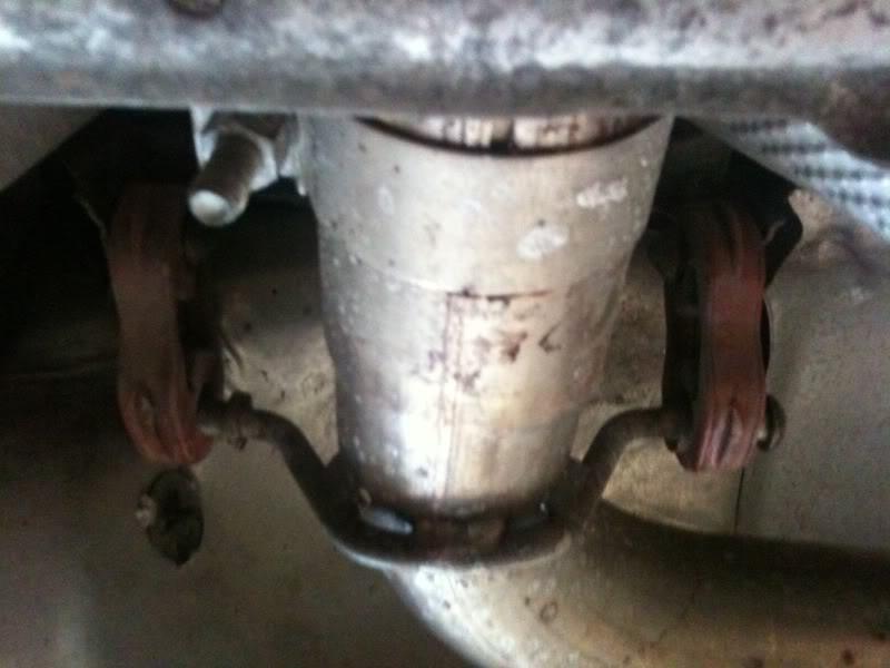

This is the exact problem with this system, it seems hit and miss as to which system is effected, wether its a difference in the car or the exhaust I dont know.....
Its not a problem with the rear section but with the joint between the centre section and downpipe and the position of the hangers. If you line up the hangers perfectly and sleeve the 2 sections together correctly this is how the exhaust sits, so you have to weigh up the correct fitment against aesthetics.

Yea you cant really turn the back box, its on hangers each side and just sits there so wont really twist.
Sliding it out the middle part might bring it round slightly though. (being carefull not to move the whole box to the right!)
Might be interesting to see where the backbox sits with no middle part connected, just on the rubbers, see where it sits. Then you will no what part it is.

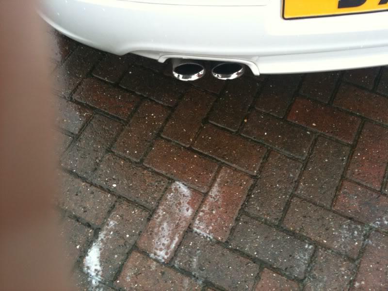

I went back to PDT and the refitted the exhaust so it was further back for me. The exhaust trims sit better, but like Dave said, the hangers seem ridiculously stretched to achieve this
