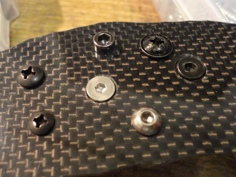

I'm pretty much snowed in, but I've got this to play with  :happy2:
Going to template and cut the panels in the rear, looking at fixings but only 1mm thick so countersinking is a bit tricky.
Offline Bennett vrs
  • Posts: 108
Re: Eddy goes on a diet
« Reply #84 on: December 01, 2010, 05:54:37 pm »
This is a cracking thread. I like the bolt bottom right mate, used to race karts and used them for alot of fixings. Its quite a neat finish compared to most of them.

« Reply #85 on: December 01, 2010, 05:58:17 pm »
Yeh I like the Stainless Steel finish against the Carbon  :happy2:
Lookin good Neil, we use a thing called a tinamun(think thats spelt correctly :smiley:) washer on the aircraft when its a thin skin to allow countersinking and can also allow for a bit of adjustment, I'll try and get a picture of said item 2 morra if you like :happy2:
Cheers gaz, be nice to get the fixings flush.  :happy2:

« Reply #89 on: December 02, 2010, 08:49:38 pm »
there you go Neil, not the best picture but i hope you get the idea, they can be had in various materials and sizes :happy2:
you drill the hole slightly bigger than the underside csk, and sometimes give the component that your mounting to a slight csk, depending on material thickness. Hope that makes sense, probably make more sense when you have 1 of the washers in your hand :happy2:
