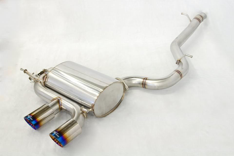

GTI no, the fueltank is split on a R32 by the driveshaft, so the R32 Backbox goes along the same line as the driveshaft, the GTI has the fueltank in the middle and the exhaust routing over in the drivers side ( LHD) around the fueltank.
GTI:
R32:

if your "MK5" is a R32 it will fit  :grin:   :P I couldn't resist big Al  :wink:  :happy2:
GTI no, the fueltank is split on a R32 by the driveshaft, so the R32 Backbox goes along the same line as the driveshaft, the GTI has the fueltank in the middle and the exhaust routing over in the drivers side ( RHD) around the fueltank
Wish you had told me that 6 months ago when I asked, found out the hard way since  :grin: :grin:
