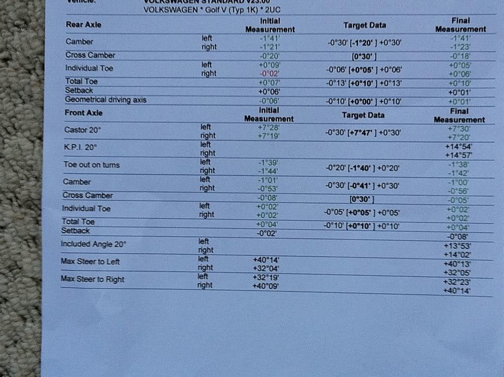

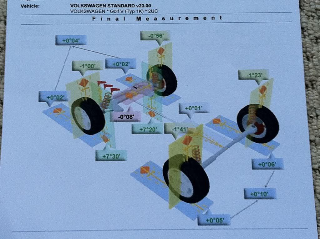

For a 3 year old car, it wasn't to bad
I used a local firm, who use equipment called Beissbarth.  Only gone a for a standard setup & to get the old girl back on track
Let the debate begin

As I always say, the rear geo is on the p*** straight out of the factory, yours seemingly was no different.
Feel nicer now?
Feel nicer now?
Haven't taken it very far, but the little distance I have driven it, it did seem better.

Lazy buggers didnt bother adjusting the rear camber!   :fighting:
i didnt think you could adjust the rear camber?

Yep.

I still need to get mine done after having the walk kit fitted...  :indifferent:
Usually makes a noticeable amount of difference when ive had it done in the past tho.
Do you know if they used the new or old settings? (i believe the old settings are the best for the rear of the car?)

Aye, iirc the old style is bugger all toe-in or camber = loose is fast!
front is fixed, rear is adjustable
