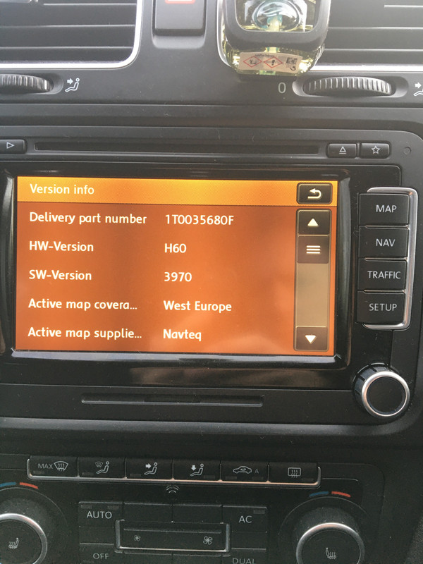

Eighteen88
Would some please point me in the right direction for updating my stereo, I’ve attached a couple of photos with the firmware and map details currently on it.
image hosting forum
