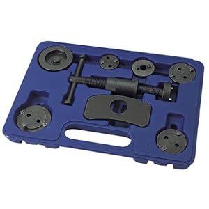

I did some on an Octavia vRS last week using a Draper windback tool - No problems.

I have found that you need to apply a little pressure to the piston, as you rotate it/wind it back.

This is what I used -
http://www.amazon.co.uk/Draper-33606-Caliper-Wind-Back/dp/B0001K9SSO
As QD says it will apply pressure as it winds
Stu...

Or just buy a halfrauds wind back tool for 9.99 pushes as it winds...
Used one for years before having to buy one with multiple attachments for RS4 rears etc etc
I agree, there are lots of them about for around a tenner.  :happy2:

I'm definatly going to invest in a wind back tool, but just confused at to why it wouldnt wind back, sometimes i was using pressure, myabe not enough as it was quite akward with the long nose pliers!
do you have a link for this, i cant seem to find it?

i got mine from halfords does a great job
