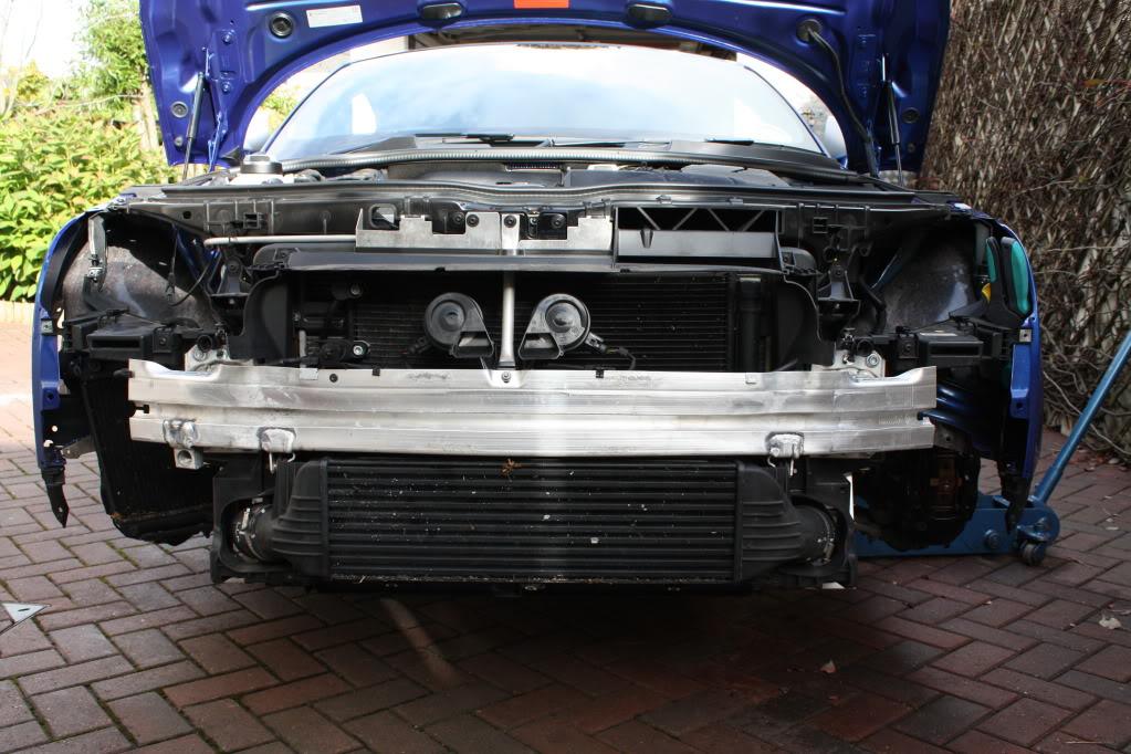

Right lads, its not for the 2.0TFSI but instead for the 2.5 TFSI.
Now the stock cooler is piddly, and suffers from bad heat soak at stage 1.
Stock
Anyhow I have 3 upgrade options available.
The wagner, the pro alloy and the forge.
The wagner is good for 460hp apparently, which isnt enough so straight off my list.
That leaves the forge and the pro alloy. Both cost the same.
Pro Alloy - 9.6 litres volume
Forge 12.6 litres
Now at first it might seem a simple choice. The forge is much bigger so thats the one to go for right? However Ive been told that thicker cores are more likely to see a pressure drop across them which is something I really dont want. Then theres also core design and endtank design, flow rates etc. Basically im hoping some one on here will know what they are talking about and will give me a definitive answer as to which intercooler would be better.
My HP aim is between 500-550 hp.

A very good place for me to start then, thanks hurdy.
The pro alloy was developed because some people where concerned about the forge unit, but the thing is we have no data to back up the concerns, but neither have we got any data on how the forge unit works on a mapped car.
I think, if the pro alloy core can cope with 525-550 hp it will be the one for me.
Jonny has the forge, but he got that before the pro alloy was developed. Ideally the best cooler is the THS one for the 2.0TFSI. A member has forced one in to his TTRS engine bay and his logs taken whilst hooning round the ring are just unbelieveably good. Trouble is he has had to modify the crash bar and some other bits to get it to fit.
Makes me wonder whether I could fit a S3 core without needing to mess with the vehicle integrity, and possibl combine it with a twintercooler
