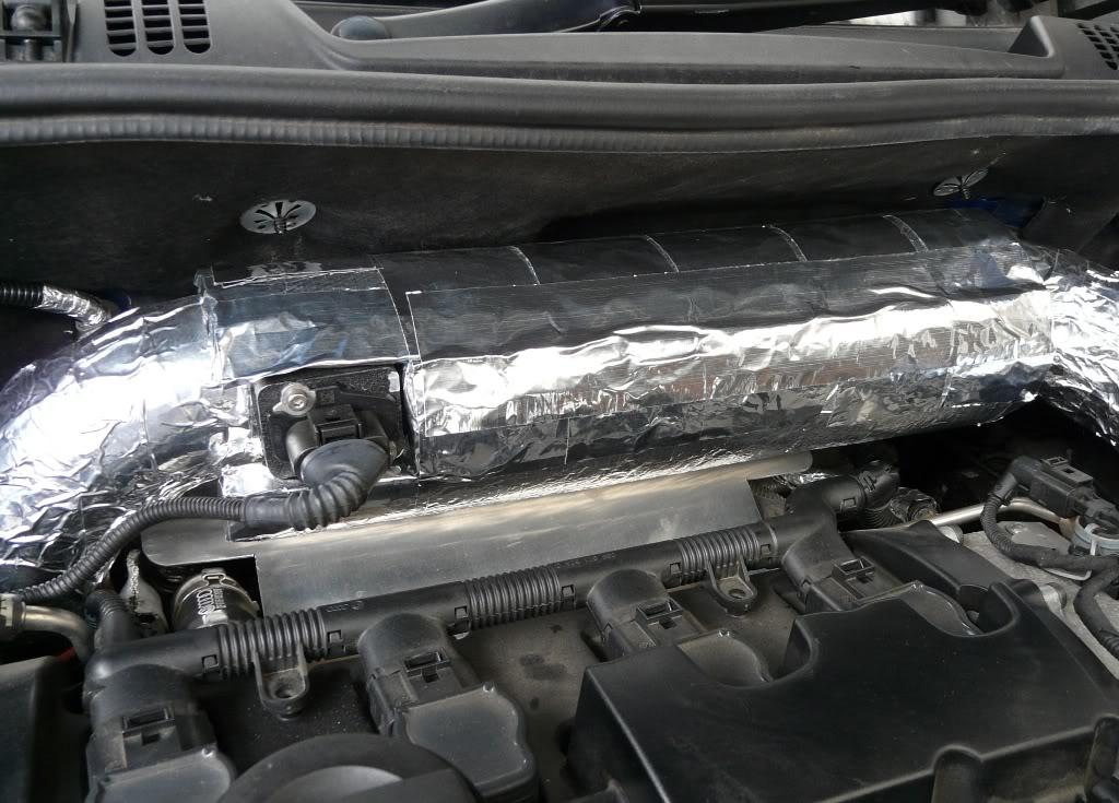

I run a P-Flow and don't have the problems you mention. Are you 100% certain the MAF has been fitted the right way up? Should be as shown below:
Also if it is making a whistling noise it might be worth checking the jubilee clamps are tight enough on the silicone hose connector.
