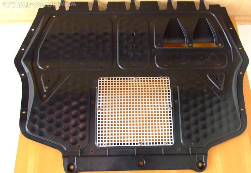

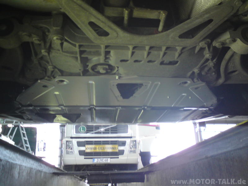

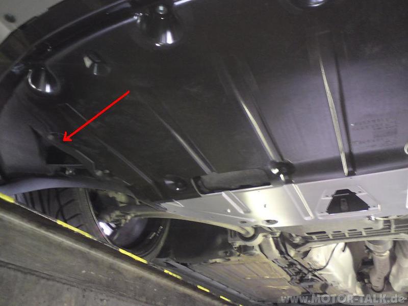

2. I took a look at the under-tray which has some heat makes on them.
I found out that the exhaust is too close to the under tray and it is melting it (because the turbo o my 1.4 TSI is in front of the engine), but no real issues.
If you feel a need I'd suggest two ways to fix it:
1.
If you still have the old small stock tray, cut one or both the NACA vents out of it and fit them
to the current big one below/in front of the engine's oil pan.
2.
Get some perforated aluminium sheet and fit it underneath the oil pan/exhaust area this way:
On a side note: The Audi TT-RS has a two-piece undertray with a rear section made of aluminium:
Of course the rear section isn't where you have issues on the 1.4 TSI.
"You get what you pay for."
